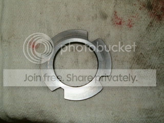

awesome Brett, PM on the way....by the way, recognize this:
after having two of these apart, I think Its a thrust washer from the spare front output.

That thrust washer goes behind the front out-put front ball bearing. The washer goes between the ball bearing and gear.
I thought that too. I had to remove and use the whole 205 front output assy from my spare 205 to put on my new 32 spline output....
