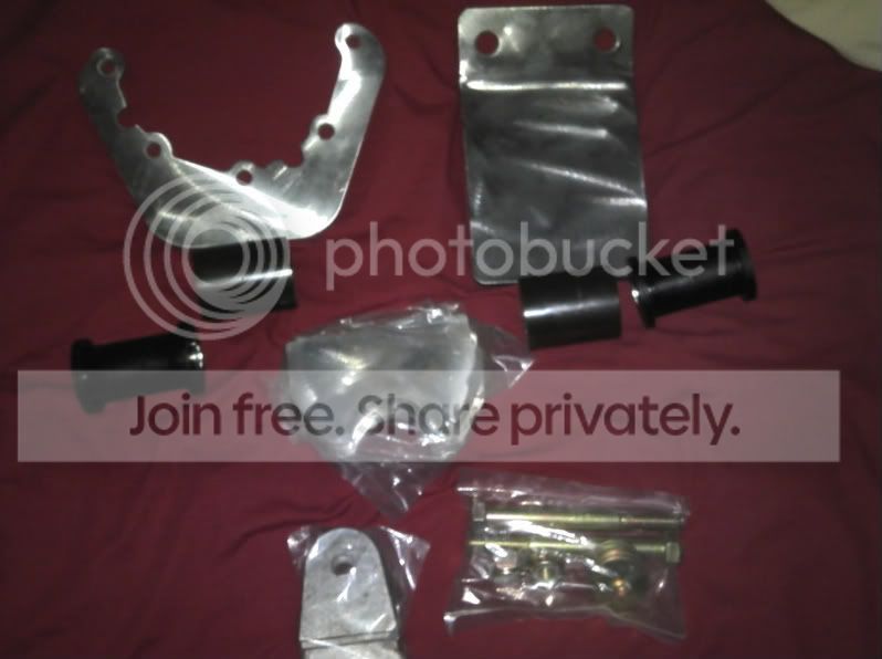

I've all ready designed and built one. I'll go find the pics in my build thread.
Here is the pic. post 315 in my build thread. Link
Kert at DIY4X has the template and all the other parts are his also. I had Kert cut it out for me.
The U shaped part bolts to the rear output housing, with a bushing under it, supported by another cross member that will have to be purchased.
The other piece bolts in place of the stabilizer rod the bolts to the side of the 205 case. it then protrudes down to another bushing, which mounts to the same crossmember spoken of before.
Weight supported from the rear, and torque held from the side. Both parts are 3/8s plate. you would need to procure a few bolts that are a little longer for the rear output housing, and re-use the two bolts from the stabilizer rod.
I forgot to mention this is for a CLOCKED FLAT 205 INSTALL. but, could be made to work with a non clocked 205 case also. it would just sit at an awkward angle.
AND if it wasn't clear, you have to weld some of the pieces together WELD with a welder.

I'm not sure what $$ Kert gets for it. I paid him for the steel and his time to cut it all out. Call and ask him.
