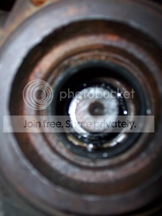

Lets start with your 205.
How many spline does it have on the input shaft?
Does it have an adaptor at all? If so, what does it mate to?
We will see what your answers are before going further.
Male Input shaft, 2X splines, i would have to go count. And the adapter is a 4 bolt (looks like it will bolt up to my tranny) But Male output on tranny and Male input on T-Case doesnt "mesh" well.
you probably have a 10 spline np205 (male input gave it away) that was originally mated to a stick shift sm465. Not the best one to mate to a 700. I would get a th350(standard 3 speed auto)/np205 combo and get a spacer and use the 205 from that combo with the 700 you already have. Or get really easy and just get another np208 and bolt that right in place.
If you have 20-something, which should be 27, and four bolt adaptor, you will be just fine mating this to your tranny as long as its the 350 or 700R4. Just have to find the spacer to fit between the tranny and adaptor and you will be set.
Oh yeah, you mentioned male input and outputs; you need the coupling sleeve to fit over those shafts. Its just a sleeve about 4 to 5 inches long and has internal splines to fit around the male shafts. If no one here has one, I've seen them on eBay.

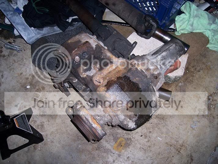

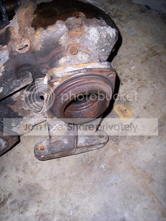

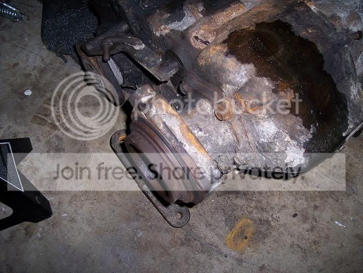

Here are pics of the 205 (incase they help)
Yep, it will work fine with your tranny, again, as long as you have the 350 or 700R4.
I don't see the coupling sleeve inside the adaptor. Did you get one at all?
Nope no sleve at all, and yes I have the 700R4.
