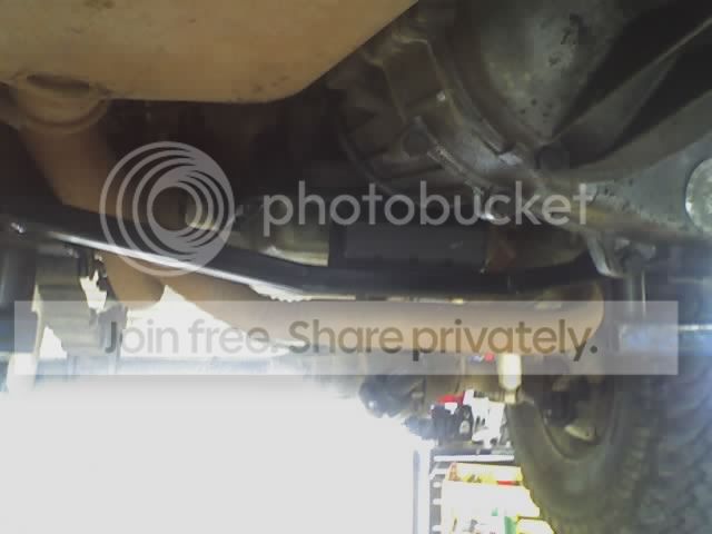

maybe something like this

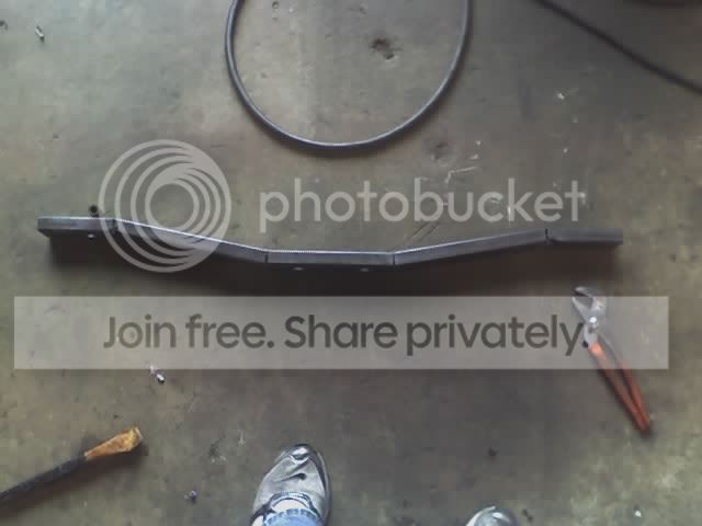

I hardcore wheeled a 208, three of them actually! I just pulled out the last one, well all the pieces of it. Here is how I built mine, It worked great for a while.

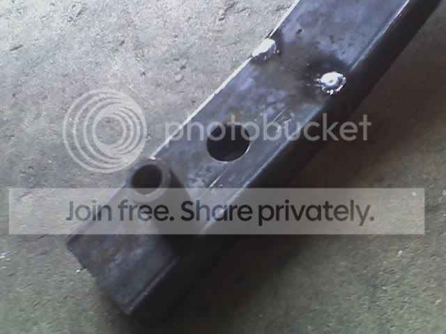

I took a piece of rectangular tubing that I had laying around and cut notches in it on the upside in the middle and the bottom side on the outside. this made it into a sort of u shape
I then drilled holes in either side so that the stock spacers would slide through.
after I fitted it up to make sure it would work I welded the cuts I had made up.

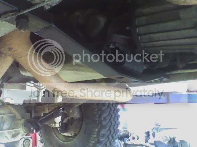

I did this part after I clocked the 208. I am trying to find some pics of the skid I built off of this...
Ill get some pics of it later, Its laying out back of the shop. If you are anywhere near Ga $40 and its yours. I also have a clocking ring for a 208, Let me make sure I dont F it up using it to drill holes for the np203
