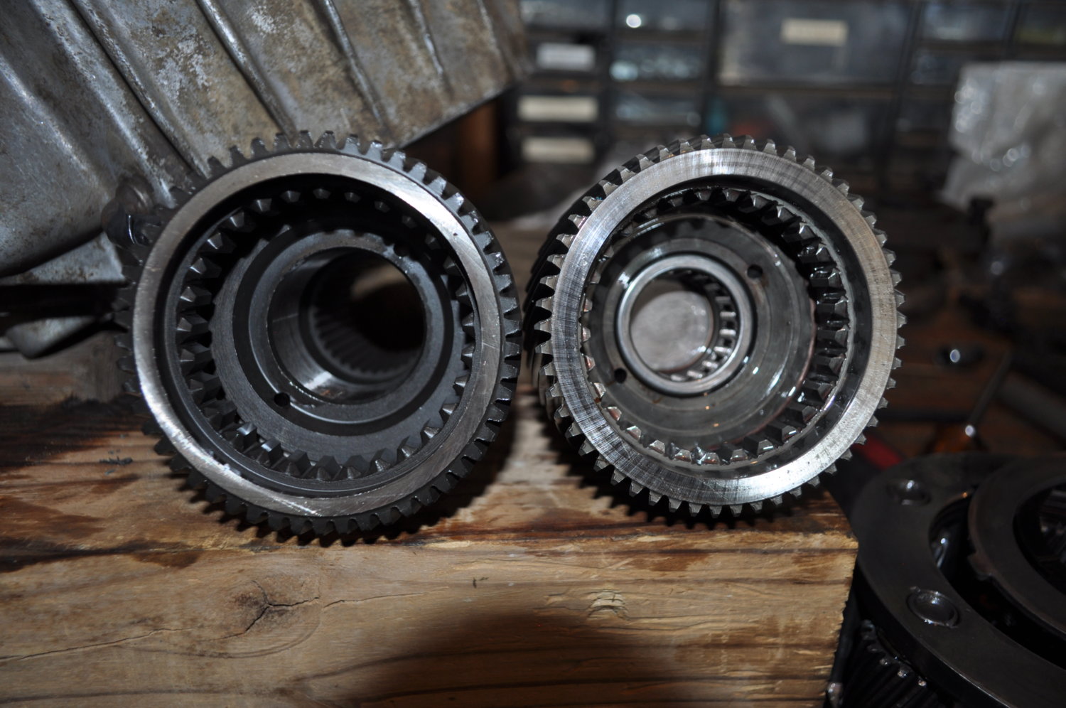

I'm going from a 700R4 to a 4L80E. I got the NP241 32 spline input shaft. I tore the case apart and as I'm getting ready to install the new input shaft, I noticed it was missing something. A bearing.
32 spline on the left. You can see how much bigger the bearing is going to be compared to the 27 spline. Does ORD have these or where can one be found without buying the whole rebuild kit?
full
Never mind. After further review and research..........It is the same size bearing. And can be found on ebay. :doah:
