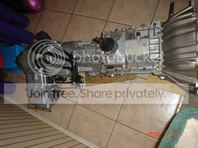

I took some measurements and made a quick sketch and had Northwest Fab make up a triple stick bracket and shifters.
Cables would be good too, as it gives you more flexibilty for shifter location.
Rene
I searched for sooo long last might lookin for you exact pictures. I saw them one time on photobucket but i just couldnt seem to find them last night. Did NWF give that bracket a part number or did that make a whole kit for this app? how does the mech linkage work? do yo like it or would yo have gone cables?
I don't know if they ever gave it a part number, but I'm sure they kept the drawing and by now have to have made a few more. The linkage worked great, but the shifters may be a bit too far back for someone else's liking. If I was doing it again I'd consider either the cable shifter, or I'd have the pivot bracket mount to the front part of the rear output housing instead. This would put the shifter about 4-6" farther ahead...
Kyle was very easy to work with.
