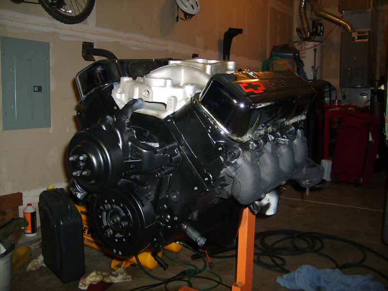

I just sold my GEN V motor plus air gap manifold for $1000 and then picked up a GEN VI Vortec for $1500! This truck is goin to be all crusin... no wheelin, but I still want to light all 4 tires up. So if anyone could throw me a bone hear on the tranny and tcase... I'd appreciate it.

GEN V sold..
New VORTEC GEN VI! Sorry fellas... Chevy Orange has go to GO! Back to BLACK soon!

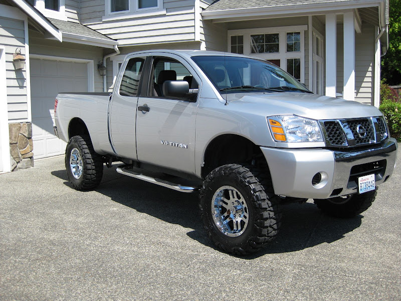

Here are the nitto's on my nissan.
nice, what size are the ones on the titan? Titan looks good too. I would love to level my superduty, but then i couldn't get my slide in camper in. Been looking at the american racing black chrome wheels a little bit though.
35x12.5 on 18's. The Nissan is a great truck. Get up and go when you need it and stops on a dime! Hopefully I can get the K5 to roll like that too! Stopping was SCARY! 38's on a 1/2 ton brakes!
