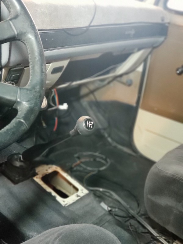

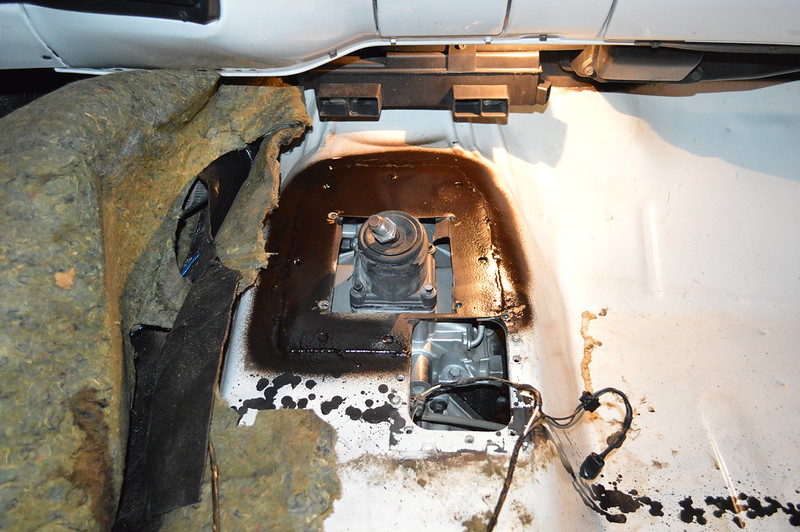

That gives me an idea where to start. If any one has measurments of the holes size or location that would be great otherwise i will play around with it till it seems right. Looks like you had a great fit how did you choose that location in the first place partially install trans and measure or something?
more pics and possible help from the 1 i did for this guy .
I made my non removable hump removable and then measured off that. Totally cheated.
But if you can find a bolt in hump, that helps imo.
It's the third nv4500 my buddy has swapped in. He's had practice.
