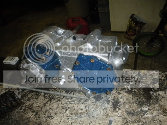

475 with out the adapter.32 spline input and both outputs.shift rails read for twin stick and the face has been drilled to be clocked.
