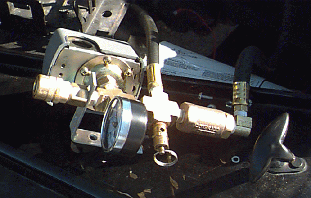

It can go anywhere really, so long as it's in the same part of the circuit that the tank is in. Mine is on the manifold under the hood. In my system the tank is just at the end of one long hose, all of the accessories and lines run from the manifold. It's just pressurized air, all the tank does is add volume to the system, it's not like stuff has to be attached to the tank in order to get to the air that it holds.

I wouldn't bother running the front port off of the tank, just run it off wherever is closest to the front of the truck. Like I said, it makes no difference where the line is hooked up, the air system has the same volume and the same pressure everywhere. You could put the tank at the end of a 200 foot hose around the block and you'd still have the same pressure and volume in the system, other than the extra but of air that is in the longer hose. Just route the lines the shortest simplest most efficient route, don't worry about connecting them to the tanks. Same with the popoff valve, put it wherever it's easy to get to, if you need to depressurize the system the popoff valve is an easy place to do it, if it's on a tank under the truck it's that mnuch harder to get to.
