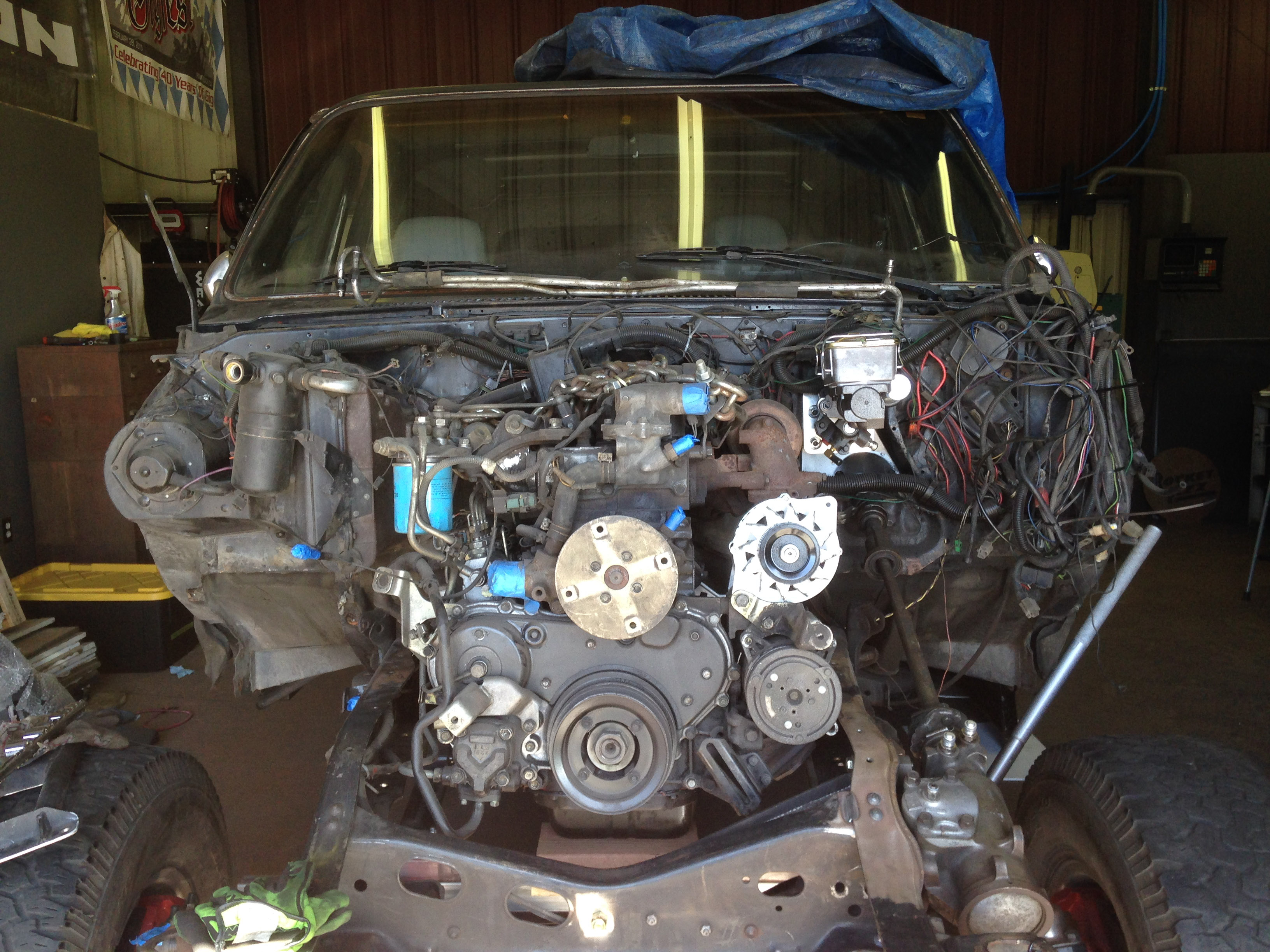

Question:
I have that stock filter for the 6.2L
What is the consensus on replacing that.
I swapped the 4BD1-T in place and was thinking of getting a lift pump and better aftermarket filters. Not that it matters with that thumper I'm putting in. There is a fuel filter that sits on the motor, but it is single stage and I would lose my heater and water separator.

Well considering the motor has a fuel filter on the block I can save that space.
Blue filter top passenger side.
I'd like to have the WIF in place tho.
After a couple hours of research I think I will stick with the filter I have and not worry about the old one. And then there might be a comparable model that I can find that will mate up and come with a water separator in place. If I can see water that is good enough for me. I don't need a light.
Thanks for the feedback.
