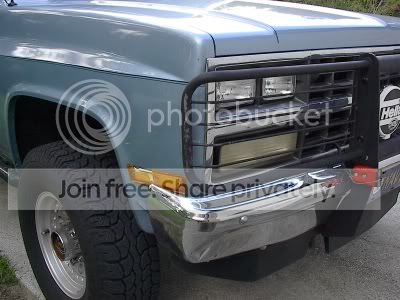

Heck, here are two of those Hellas on my '74:
http://www.slosh.com/ck5/with-52sand-56s-3.JPG
-- A

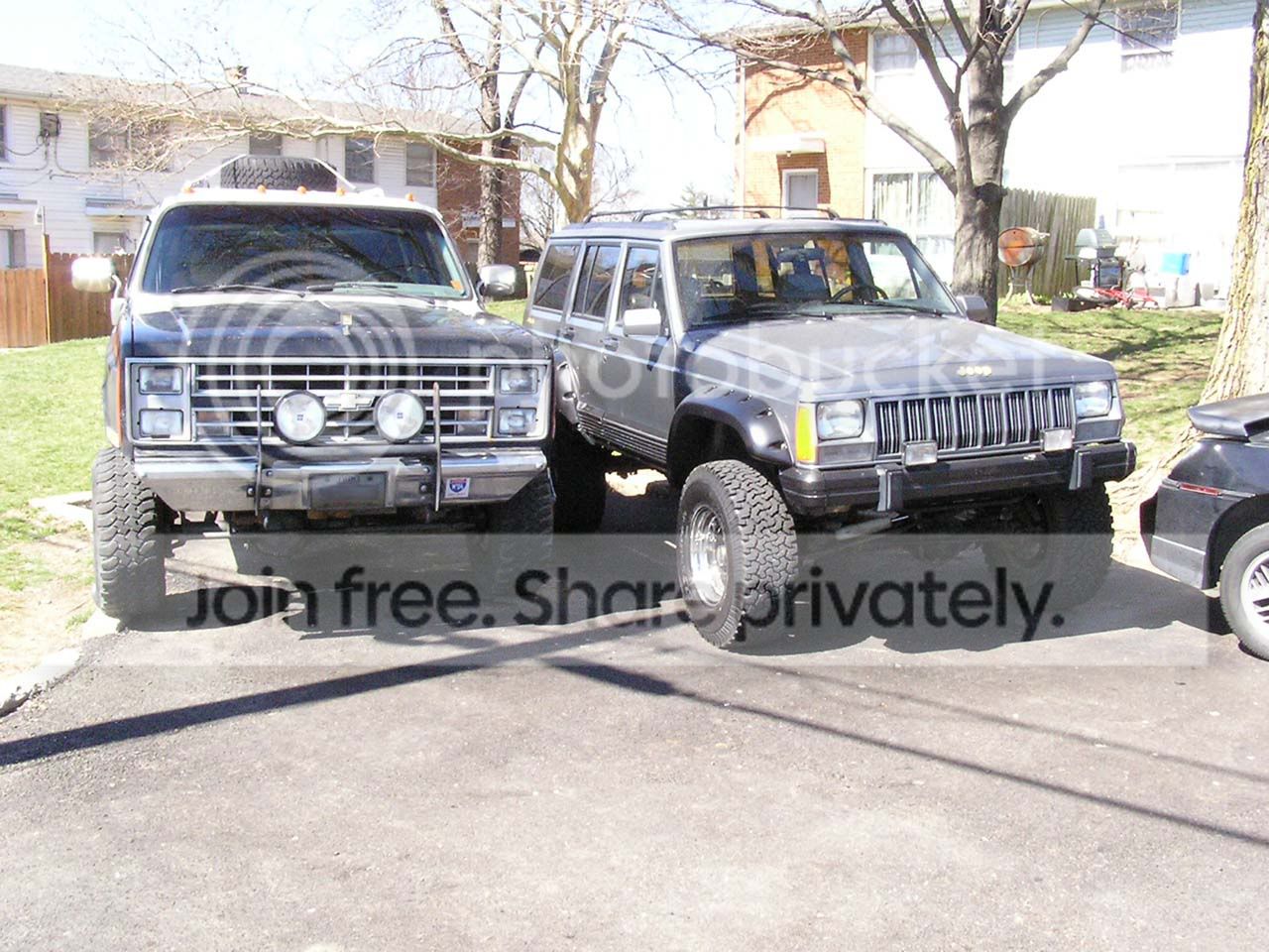

Im running 4 pro-comp 10 inch lights up on my roof and I have to say I was very suprised at their performance. I bought them when 4 wheel parts had em on sale. I think it was buy one get one free. When I finish my bumper Im going to have two HID's on the front with the pro-comps up top. I agree with the above, the mounting setup is kind of hokey but you get used to it. Once I got them set I havn't had to worry about them much.
~Brian

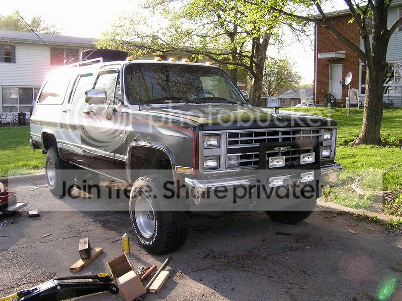

I have been through the whole gammit of lighting on my truck (I think I'm stuck in the 80's or something) from KC to PIAA to Hella . . . and on.
The KC's suck to be honest, poor lense and reflector design, fell apart easily then rusted up.
The PIAA's cost a fortune and had a great lense, reflector . . . made a lot of light in the right places with little power draw, but cost a fortune (and had the best warranty, 2 years later parts can still be replaced free)
But now I only run Hella, they cost less than the PIAA and work just as well.
I have a set of 450 fogs, 550 drivers, and now a set of Rally 4000 Euro beams. The Rally 4000's are the none HID version of the ones mentioned above, and ran me $200 for both off of ebay. Those lights are killer!
The 450 fogs have a very nice flat wide beam that if mounted low enough really cut through the thick stuff.
The 550's though are the best all around supplemental lights I have, deep focused beam with enough side light to greatly increase driving safety, and they only seem to bother the wimpiest oncoming drivers.
Sorry I don't have a pic of them all together (the 550's are on my Van right now anyway)
