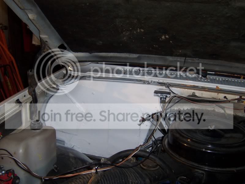

I removed all my HVAC stuff, really nothing to it... just dig in and yank it all out. I cut out some sheet metal to fill stuff up and RTV'd/Screwed it in place.

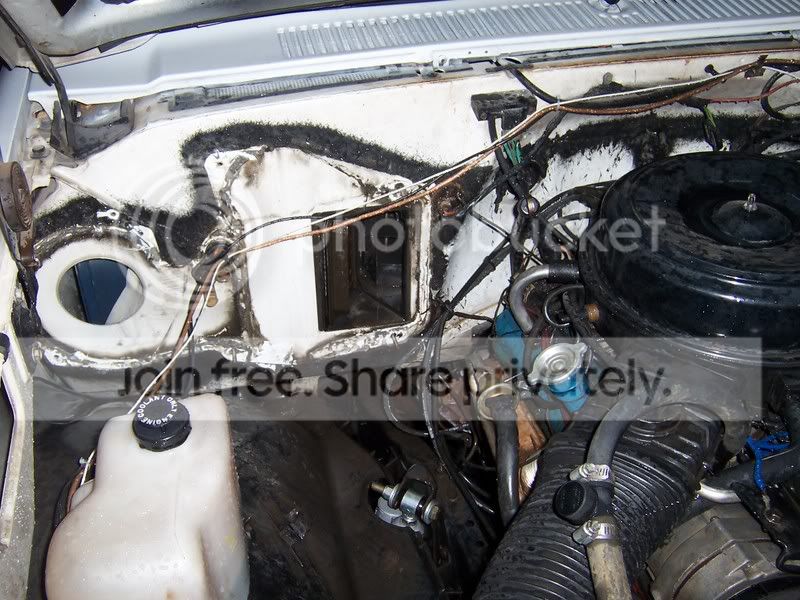

I removed all of my A/C stuff during the recent engine swap, but i just trimmed the enclosure so I could retain the blower for heat. I'm in the process of fabbing up a new box to run from the fan to the hole in the firewall. It drops into the low 20's every once in a while here and i'm not a big fan of cold weather anyways haha.
