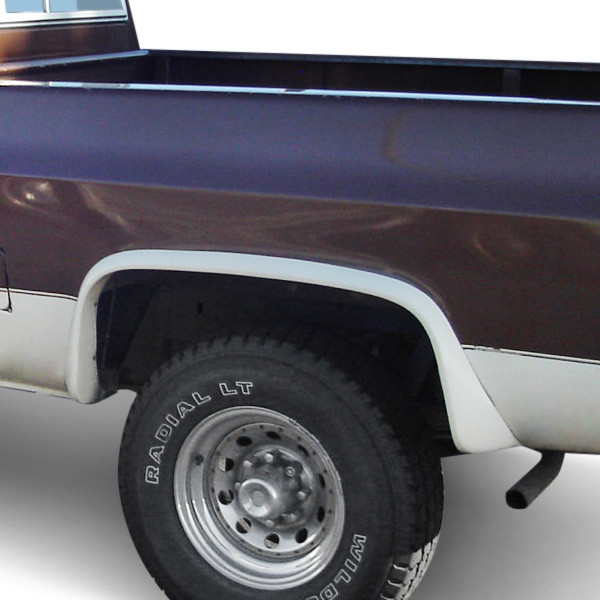

Not meaning to hijack the thread, but what flares are these? Love the way they look.
These flares came with the truck when I bought them, but I believe they are made by a company called Bushwacker.
