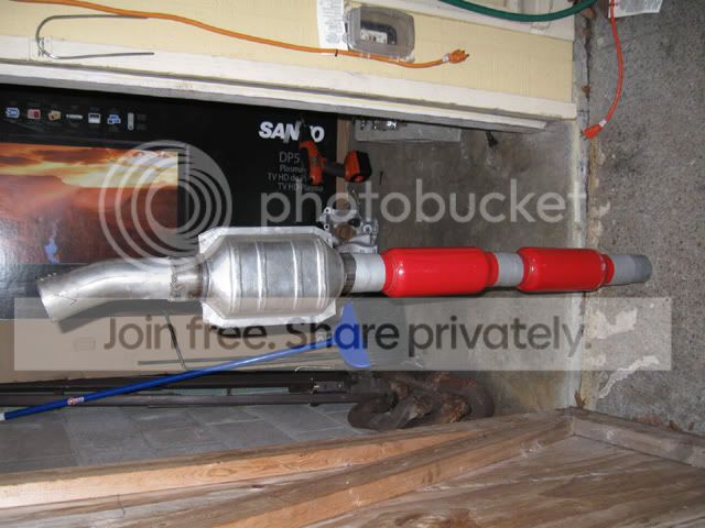

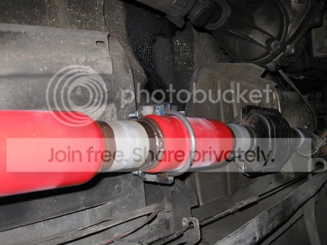

Finished candy cane exhaust. Got my tailpipe put on today, but a magnaflow cat, 2 8" cherry bombs.

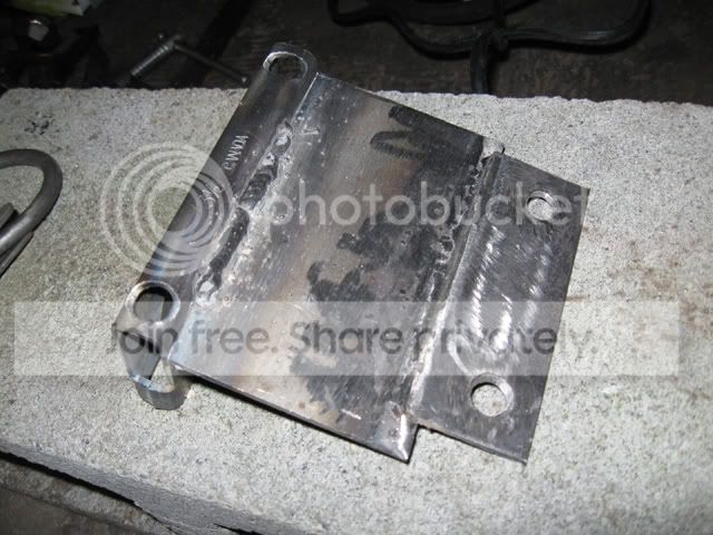

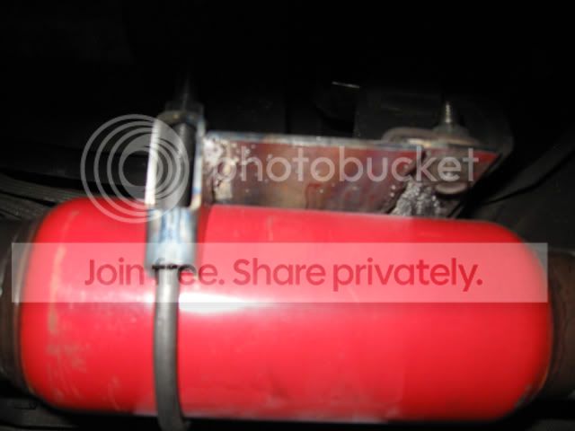

And the bracket I made cause the stock exhaust bracket wasn't far enough back, so all of the weight was at the cat/y'pipe, so I made this one to go as far rear as possible to kinda center the weight. But it's removable, and mounts to stock bracket.

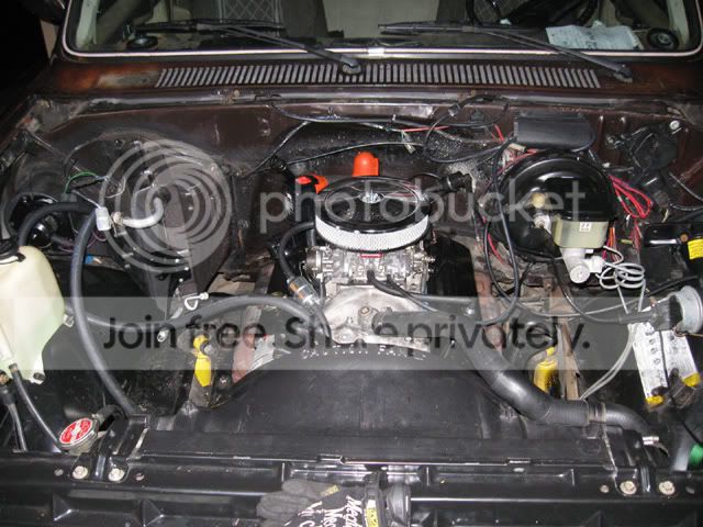

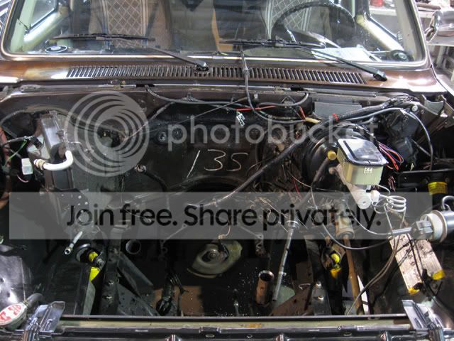

New engine almost done

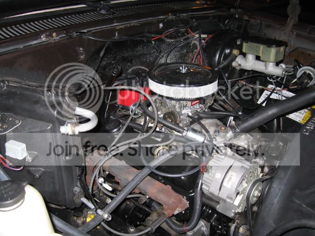

Complete... for now
So GM performance 290/350, new MSD Streetfire distributor, water pump, power steering pump with high pressure/return line/pulley, alternator, motor mounts, hoses, belts, harmonic balancer, fuel pump, fuel line, fixed the stock oil cooler (kit was $10) Exhaust manifold will stay for a while, which is why the cheapo exhaust, it's gunna get all redone.
