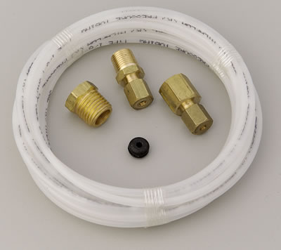

Maybe your missing the point here... Your buying a whole new gauge, not using your existing electrical one... They come with tube and fittings... you put a fitting in the block and run the tube from the fitting and hook it up to the back of the gauge..
heres the unit i run, (couldn't find a pic of the back of an oil pressure gauge to show you how it hooks up) note the comment in the lower right corner on how it comes with tube and fittings...
http://www.autometer.com/cat_gaugedetail.aspx?gid=2717&sid=9
Tho, I just thought of something I've never seen before that would work if your are insistent on using your current electric unit.. Little hokey, but it would work...
you could use the fitting and hose from a mechanical, run the tube to a remote location away from the block (maybe on the firewall) and hook an electrical sender up there, using the same style fitting you put in the block, then a 1/8 npt coupler, then an electrical sender to feed the signal to your current gauge..
Damn, there you go, 2 avenues to pursue....
