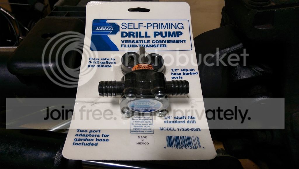

I use one of these. Hook it on a cordless drill and pump a gallon of gear oil in no time. They run about 30 bucks.

I have one of everything described. The hand suction pump I use the least. The pressure bottle is pretty much strictly diesel for priming big engines. My drill pump and electric pump are for my oils.
