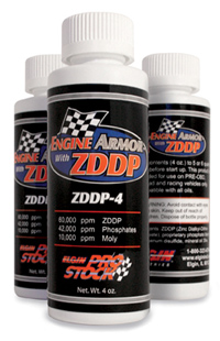

I run the 15w40 Rotella in the Maidens 454...I do take it pretty easy til the engine gets warmed up though. I got flat tappets and solids, so I add some ZDDP additive to each oil change as well...Most of my engines are flat tappets so I buy it by the case.
I got something similar to this from NAPA.
Always like your recommendations Dave! Why the fock didn`t you tell me that when we were a NAPA buying oil for it! :haha:
