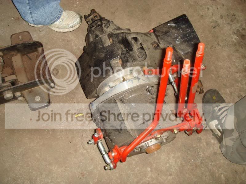

my chevy 203/ford 205 doubler clocked belly flat...
im also not running any cv's in my WHOLE truck..im running 1410's all the way through with a rockwell shaft in the rear

im running 5 and 3 and 44s...lots of cutting....the rear driveline im not sure about but the front should be alright because im running a hp60 and the doubler pushes the front output so far back since im running a 700r4 and the 2 inch spacer for the doubler
