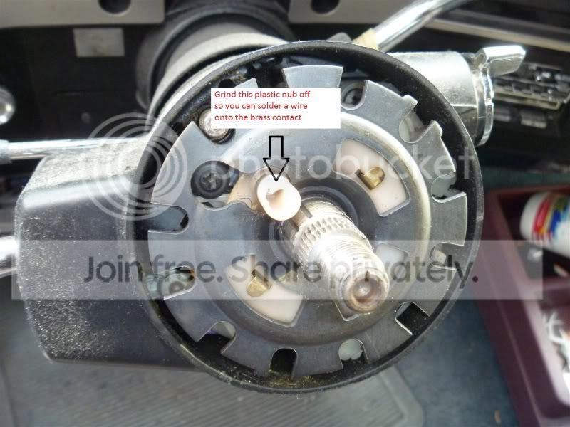

Pulled the old one off using my steering wheel puller. The horn was the only thing different and it's required for NY inspections.
Some dremel work and a soldering iron was all it took.

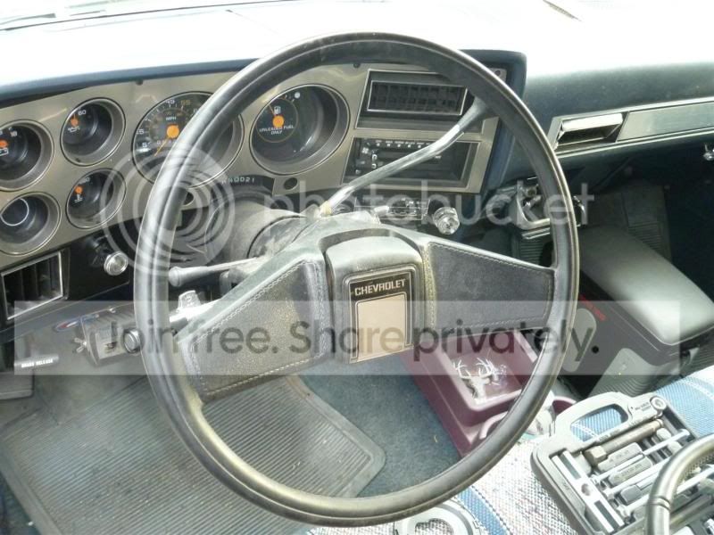

Old steering wheel
This is the part you have to modify for the new horn to work. I cut it off with my dremel tool so I could solder a wire onto the contact at the bottom for the new horn button.

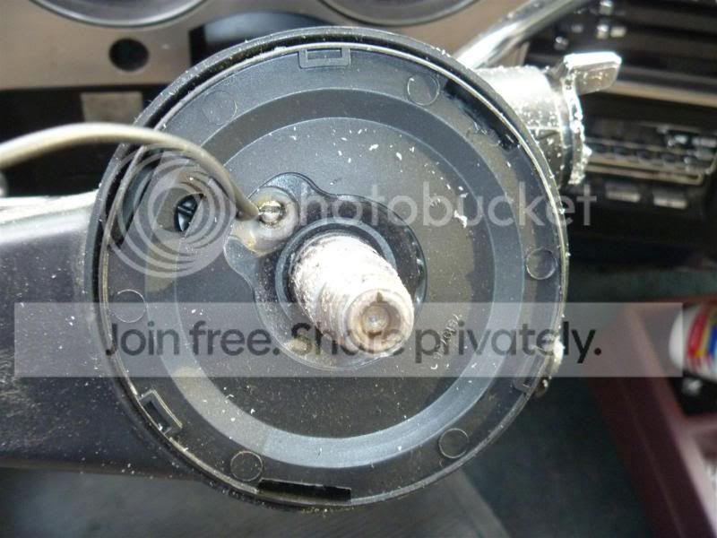

This is the back of the new horn button where the wire attaches

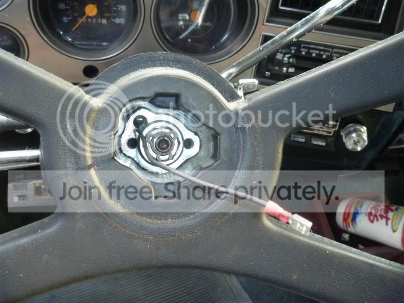

Install new wheel, nut and snap ring, routing wire through the larger non tapped hole

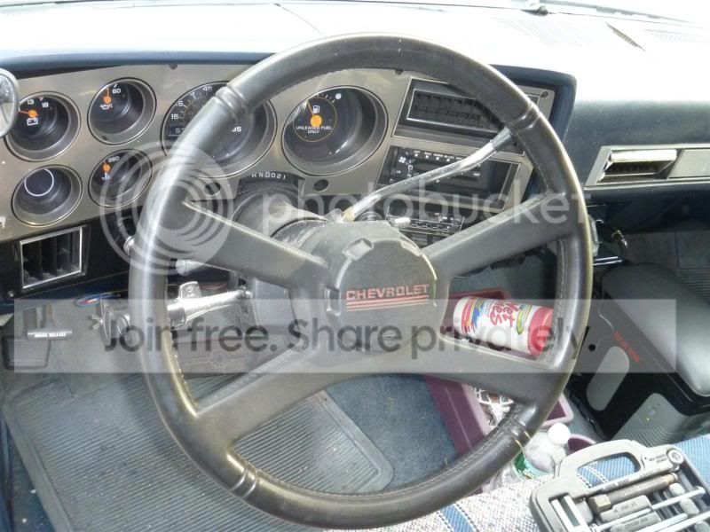

Here's the new wheel with working horn. It's a little smaller than the original but feels better.

You must not have gotten the horn wire for the new wheel? I pulled one of those out of a junkyard truck and it was a direct bolt on. I grabbed the wire too which had the "male" end that slips into the white plastic nub you had to grind off and locks in with 1/4 turn.
