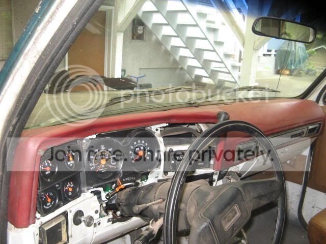

The dash frame is the same from old to new, it's only the dash pad that is different. Here is a pic of a '78 dash pad on my '90 Blazer.

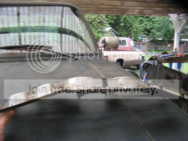

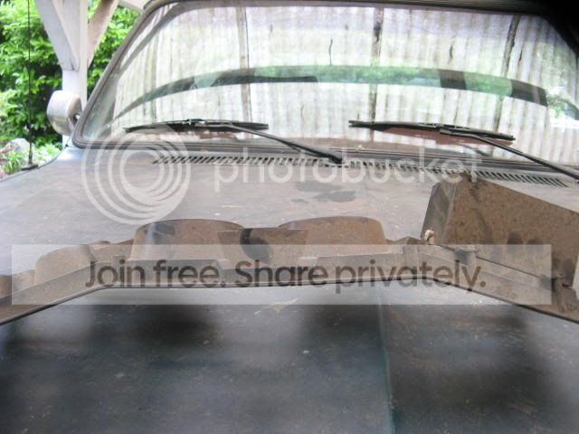

You'll need the older bezel though, these two pics show the difference between the older and newer bezels. It's mostly depth...
Older style:
Newer style, which is about 3/4" deeper everywhere.
Probably the biggest issue I see so far is the older style dash pad covers the VIN on the newer rigs... :doah:
The older bezel doesn't fit my truck, the headlight switch is in a different position. Looks to be about 1" higher than where the old style one was. This red dash I have is in pretty good shape, and would fit my needs as I'm also swapping to a 70's front clip. I may try to make a clean VIN window and possibly carve the newer bezel so it'll fit the older dash pad.
