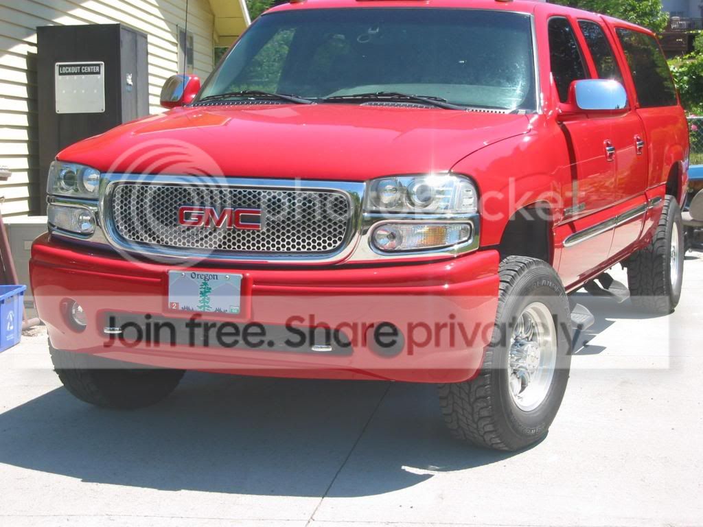

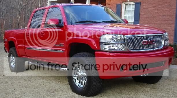

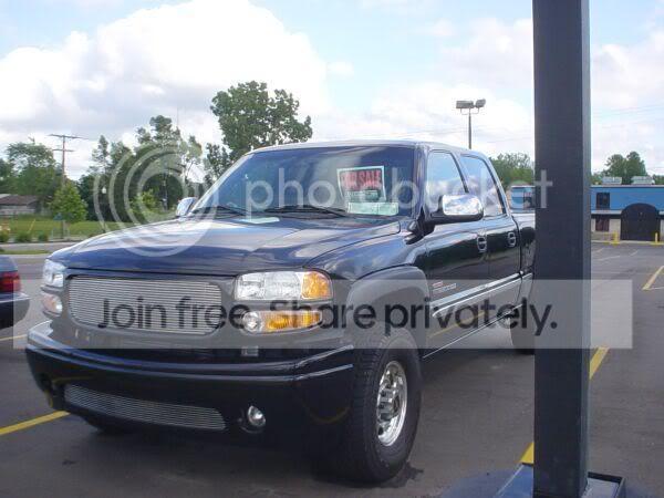

I have had the bumper off mine - I would recommend going Denali!

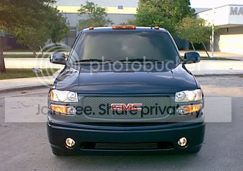

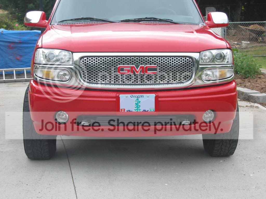

I put the Denali bumper on my truck - mine is an '02 GMC -

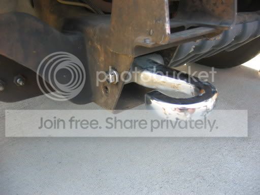

I made several different brackets to lift mine. I swapped my towhooks left to right and flipped them over - drilled two new holes in the frame, and wedged the end of the towhook between the blocker beam & top of the frame pocket.

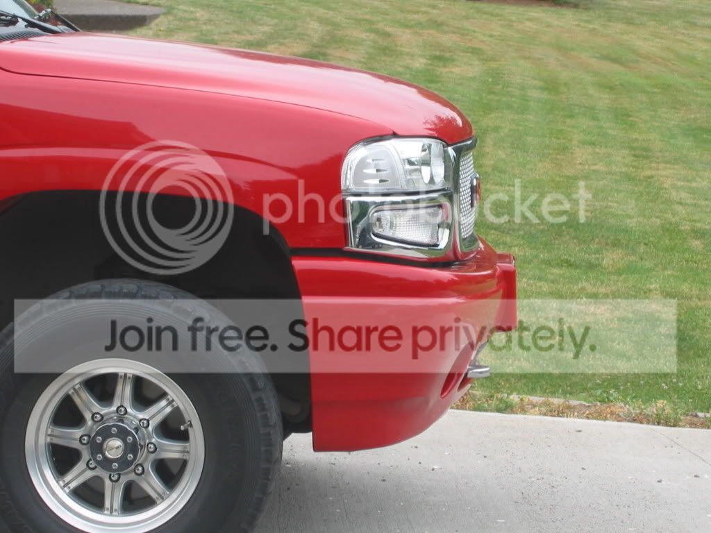

I didn't have to trim my frame ends - just some areas of my core support. I'm pretty happy with how it turned out - now just need to save $$ to lift it a little bit...
Before:
After:

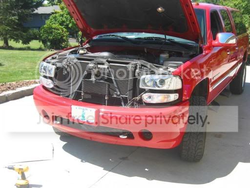

During:

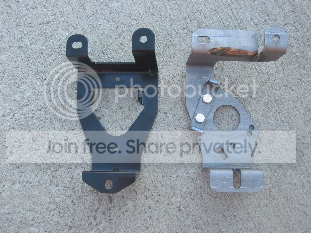

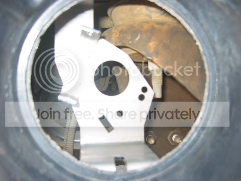

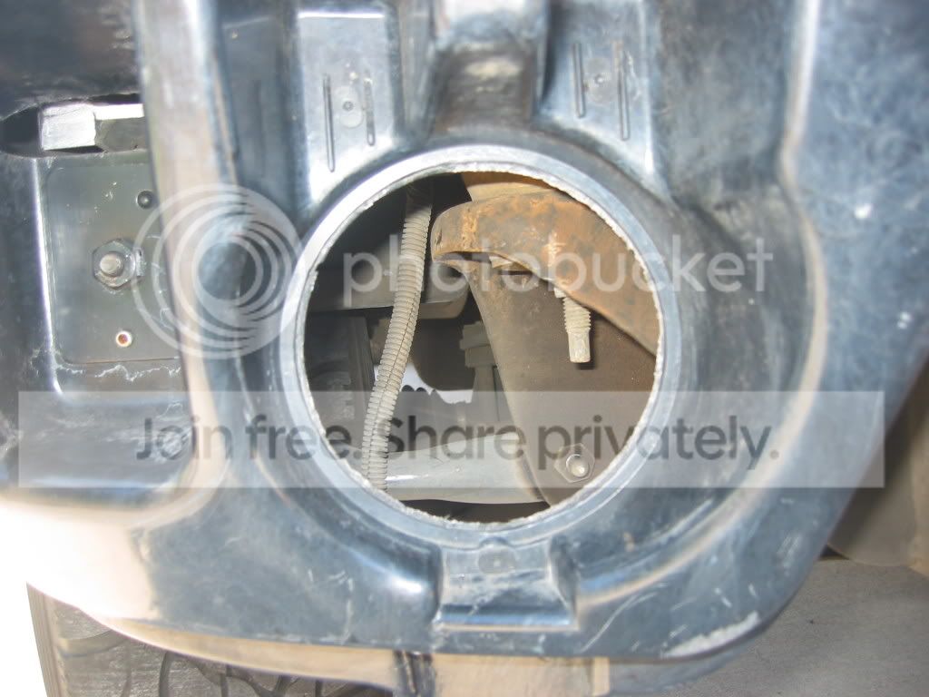

The stock 1/2 ton Denali fog light bracket and my fog light bracket designed to clear HD frame
After:

If you space everything out - it's not too bad. You can use your stock GMC headlights in the Denali grille, and can pick up stock Denali yellow turn signals for very cheap on Ebay. I've started to see aftermarket Denali grilles now on Ebay - which was my most expensive single part ($280 from dealer). I bought my outer bumper off Ebay for $100 - it wasn't perfect - but I had to get it painted anyway - and my painter did an awesome job... I got my inner bumper support from an autobody shop - it is cracked in several places and they were throwing it away... The bottom black grille I got off Ebay for like $20, the clips, license plate holder, and turn signal valances I ordered from Sam Taylor Buick Cadillac:

As for how long it took me - about a month to get everything fit up right - but I wasn't always able to work on it - I designed the brackets as I went - I had to design the fog light bracket, an outer bumper support - which was a simple flat bracket, and a 2" lift for the bumper (which I used square tubing on - and drilled a hole - bolted it in the stock location) This is a pretty straight forward swap - you have to trim the inner bumper and your core support here & there - but nothing majorly structural
- I drove my truck for quite awhile with no bumper or grille - everybody at work was giving me sh*t - but I think the results were worth it. I collected parts for about a year and a half before pulling the trigger
