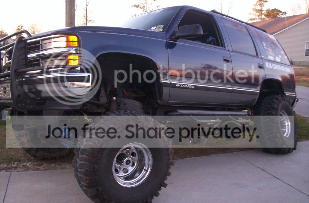

Here is a pic of my latest cuts. I didn't get above the stock lines because I have no reason to. I still have issues under my radiator support though.

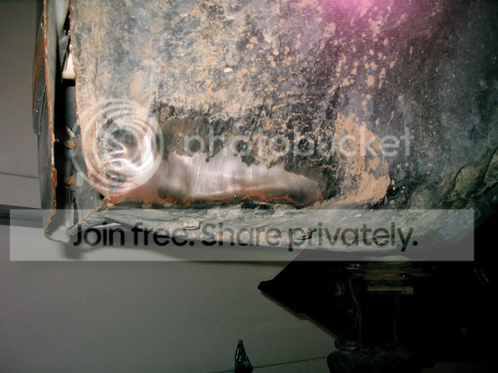

Inner fender under the radiator. Not sure how to cut it yet.
Do you really need to cut it? Is it actually hurting anything? It doesn't appear to be hitting a sharp edge that will cut into the tire.
Martin
No it isn't cutting the tire, but it does restrict its movement and rotation when its stuffed in there hard. :wink1:
