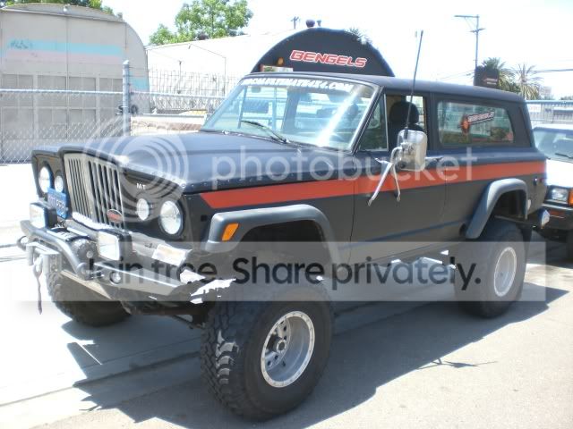

Ok guys, I am in the process of building a tube rock car that will not be street-able. I also have a Bastardized vehicle that I am considering turning into a tow / recovery vehicle.
I have a 74 GMC Jimmy with an 2.5 inch extended frame. It has a 3" spring lift on it. Im thinking about finding a cheap Burb and swapping a 454 d60 /d70, tranny and t case into the rig. Id like to throw some bags in the back for towing that can be removed fairly easy for recovery if needed.
The reason I want to keep this vehicle and not get another is that this vehicle is smog exempt and Im really digging that here In California. :whistle:
With the upgrades the brakes should be ok and I do have trailer brakes as well. Is it going to be too short? Ideas suggestions? The rig...

Basically short hauls 300 miles round trip. All hwy with a few good grades. It is a tandem trailer with breaks as well. Ive seen those guys pulling trailers with short tow rigs when the trailer starts to dance then leads to whipping around. I'm under the impression it is probably do to not enough tongue weight? But it always seems to be being towed by a short wheelbase vehicle so I'm not 100% sure?

Thanks for the info. Im Close to El Cajon and go to the southern lower deserts most often. I don't do Cajon pass! LOL
So I am confused...
Are you building a 77 k5. a burb, or this FSJ for towing?
Or is the FSJ going to be the rig on the trailer?
If you are building the burb for towing, it's not really short, if it's the K5, then yes it's short but load leveling hitch is your friend.
I know your FSJ is smog exempt, but the 77 isn't right?
