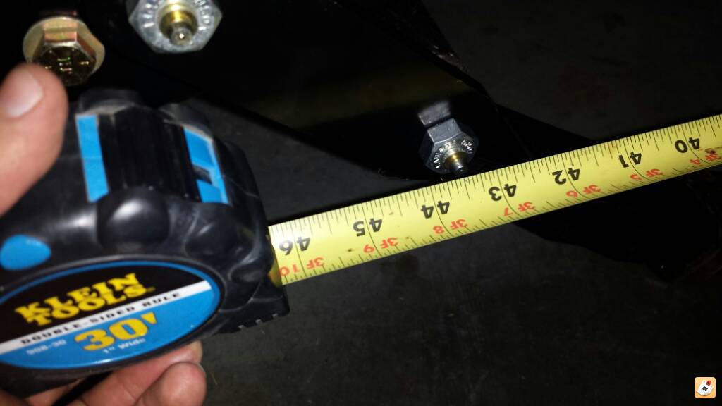

I went to install my leaf Springs tonight and there might be something wrong with my custom Springs from ORD
I installed the front and everything looks okay. The only concern is when I put weight on it the rear of the spring will flex up into the frame instead of down?

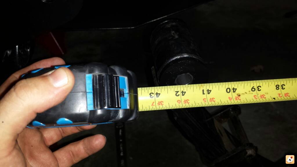

Now the rears must be wrong? They're very short? I can't even bolt them up at the shackle?
I thought the rears should just bolt up but they're only 42" eye to eye??
Any ideas?

Measuring eye to eye doesn't mean anything. Measure along the main leaf. Those are some really tall springs and the rear eye is going to move way back when there's some weight on them. Whether or not there's a risk of inversion on full droop is a valid question, though.

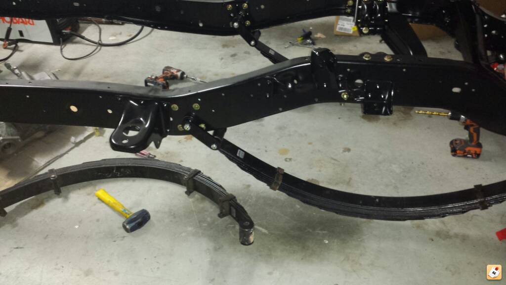

I know that the rear 64 inch rear Springs I got built by Stephen required me to cut a 2x4 to length and compress the springs under a rack and slip the board between the eyes so that I can get them to reach the shackle to bolt them up.
Seriously, measure the real length. I bet they are longer than your stock spring. When you asked for a million inches of lift, how did you expect them to look?

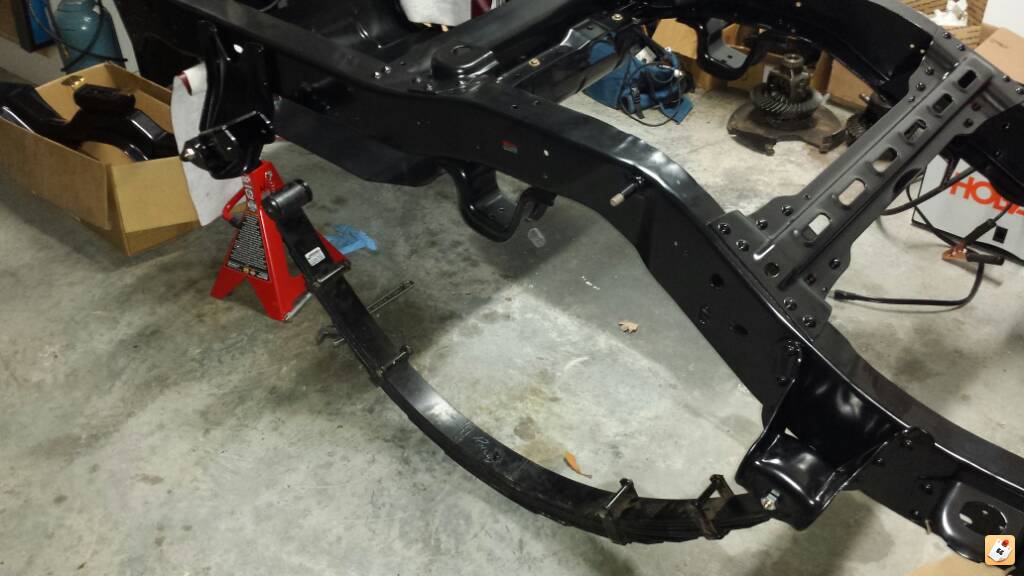

ORD springs are soft and have a ton of free arch. You don't have any weight on them, so they are going to look weird until you do... IIRC , mine were a 4" lift spring but had almost 9" of free arch. Once they were installed with the weight of the front end, engine, etc, they sat perfect.
I'll give you 99% odds that the springs are actually fine. :deal:

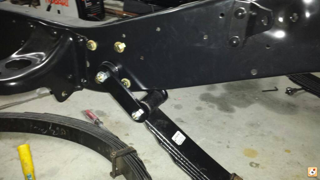

So I have attached it at the shackle and I think if I put a jack under the center of the spring I can stand on the unhooked end and get it to straighten a little?
Only problem is there is no weight on the frame so not sure if its going to want to move.
GOT IT!!! RATCHET STRAPS AND LEVERAGE

If your shackle is inverting under pressure now, see what the angle looks like once you've got the axles bolted on, it might flatten them out enough that the angle looks right again.
