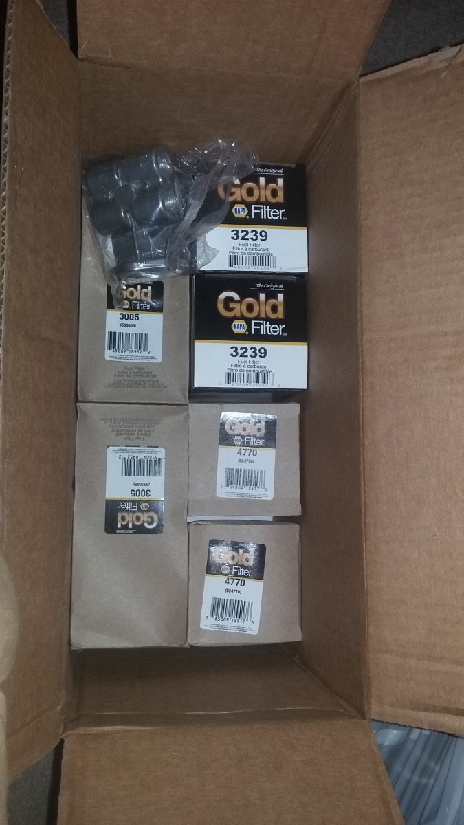

Ordered some filters & bases for my 6.2l
Big Ray
The Older I Get, The Grumpier I Become!
May 17, 2009
20,793
19,962
Eastern NC
last night. going to rig a pre-filter for my new Walbro fuel pump. And replace the box filter with a spin on with a water separator.
pre-filter
main filter
filter base
and the new lift pump.
I have a new wiring harness for the pump. I got both from Leroy Diesel.

Looks good. How much did the Walbro pump cost? :thinking:
$145. Got it from Leroys

oh yeah, lots of 6.2l goodness came in today...
full
