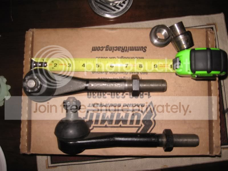

Figured I'd bring back a dead thread cuz I searched and didn't wanna start a new one. I have these for my crossover draglink but ORD ends look wayyyy shorter and different. Will ORD draglink work if cut, do I need to order someone elses draglink, or just find some tubing and build my own to fit?
I have the tube adapters for them so either way will work.
yup, those will be too long. i have just one of those in my draglink from them and it barely goes short enough. i ran it the whole way in.
I wouldn't use those ends, with hydro assist and big rocks they will break... ask me how I know.
well without hydro assist and without big rocks what draglink did you use haha?
really though are they bad enough to not use them and go ahead and buy ord draglink and short ends? just not tryin to spend a hundred bucks on new ends if i don't have to cuz I spent 60 on these:doah:
I would return those and get short ends and a drag link that matches them. I have seen the Fox carnage first hand and it really didn't take as much as you would think to bend them.
