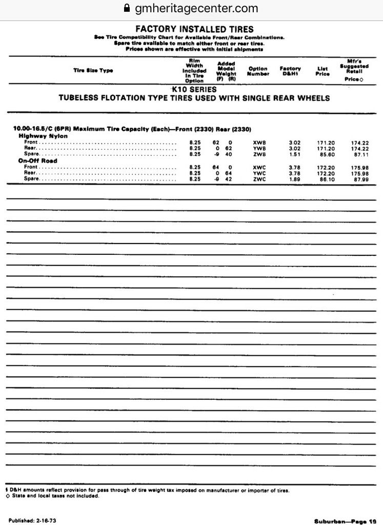

Well this is for 73 Suburbans, but I'm not that familiar with the old tire sizes.
I don't see 31's listed anywhere for the Suburban, wonder why the K5 had them?
Would be interesting to see whatever that brochure is, but for the K5.
I must be missing something. 1973 Blazer is not listed. Definitely 31's listed for the K5 though, and not for the Suburban, even same year. I didn't go through all of them, but for the OP, even best case, he'd only be "legal" with 34" tires.
