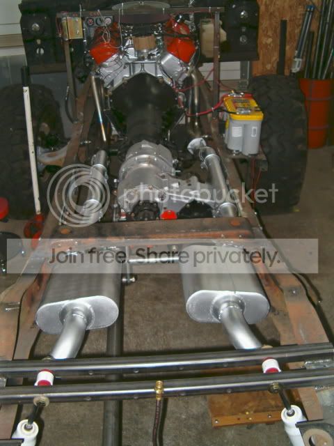

Outside the framerail exhaust?
This is mine with a T400 clocked up 2".
wow, thats tight, how will you keep heat out of the cab? its weird this came up now. i just saw a set of sbc fenderwell headers for a tri-five chevy for $350 on my local craigslist & was going to ask what anybody thought about them in 1 of our bodystyle truck. from the pic it looks like they may would work, i want to see them in person.
I have some titanium cloth wrap that I will put on them from the flex joint to the mufflers.
the mufflers have the heat shielding metal mounted to the body underside still, so we'll see how that does.
