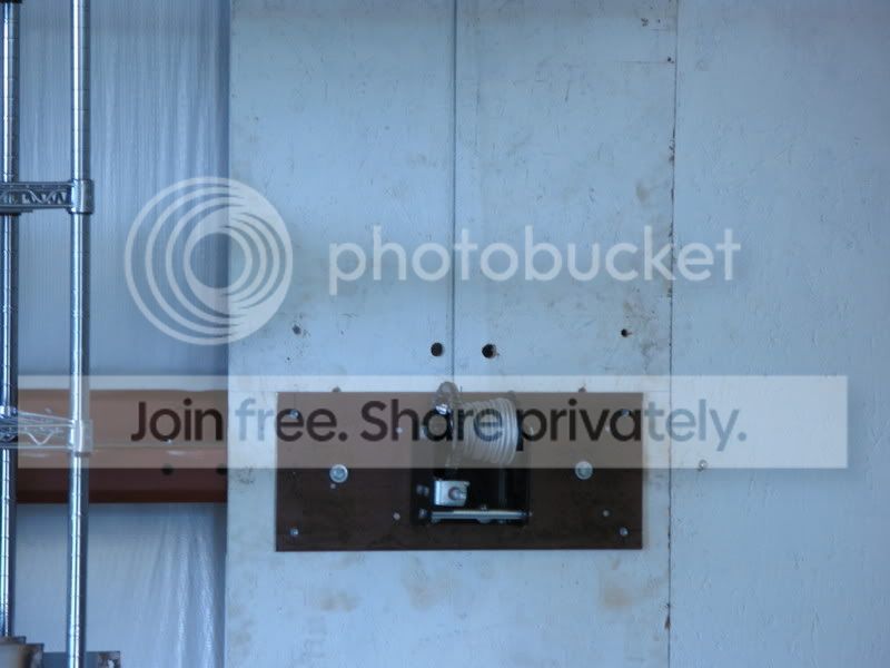

I took the cue from the tech article and ran with it. These are the pics of the results.
The worm drive winch

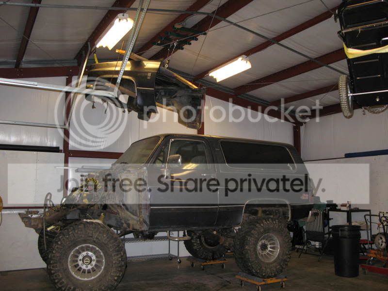

Handleing the load
More room to work with
:haha: didn't you take the wrong half off. On my first gen it has a removable top not a removable front end. Whats next rag fenders?
J/K.... Looks like a nice setup. Wow it looks like you have a nice place to work on your rig.
