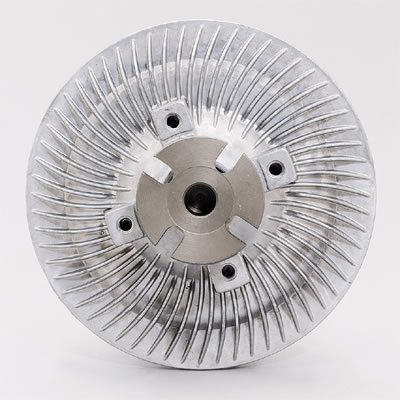

I say the fan clutch is leaking. Pop the hood and try spinning the fan, if it turns nice and easy and almost freewheels and you may or may not see that the clutch looks oily then it is probably bad. If it has a nice stiff resistance and it looks clean than it probably is something else.
It's a friction clutch. Here's a pic.
The clutch is bolted to the pump and the fan is bolted to the clutch.
When the temperature gets warmer it "locks-up" and the fan spins with the engine. At a relatively cooler temp, the fan is allowed to kinda spin freely and it lessens the load on the engine.
