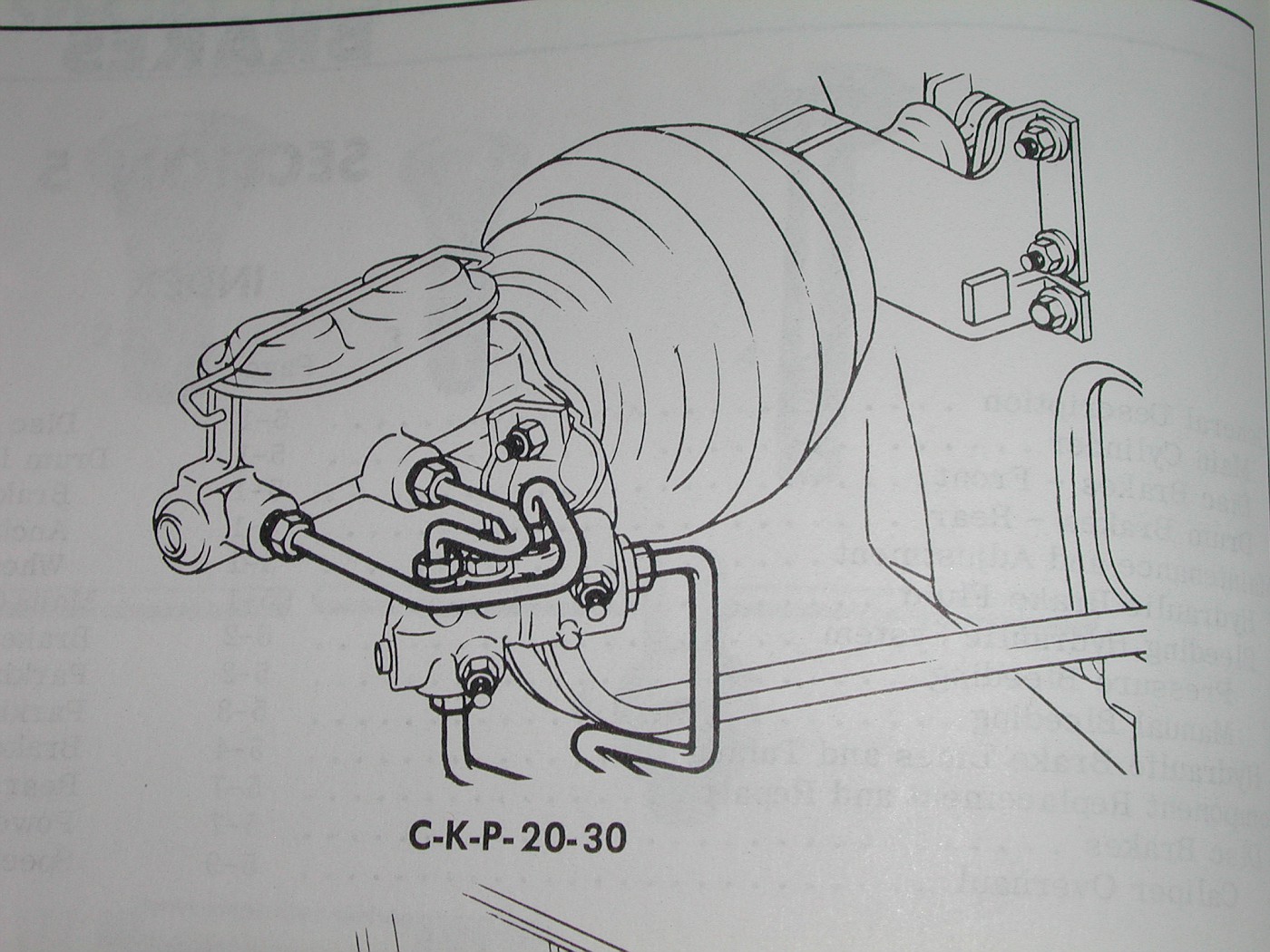

    I believe the 3/4 + 1 ton stuff is reversed like that.At least that what it looks like in the manuals.
    Here's the 3/4+one ton stuff.
    [​IMG]

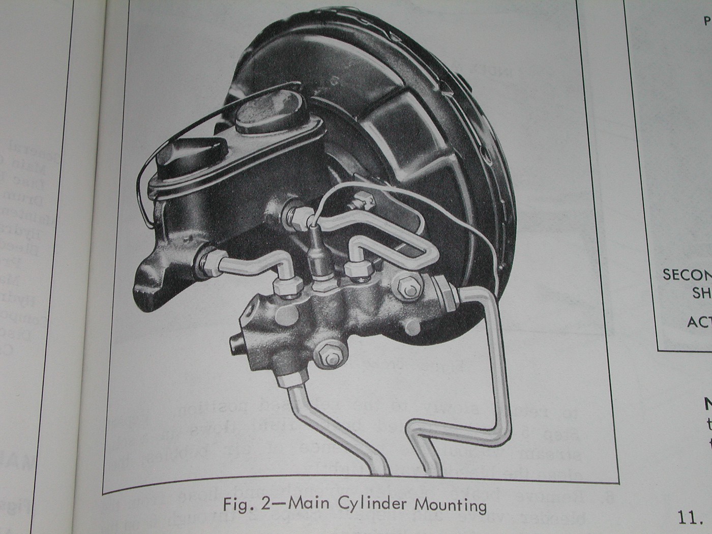

    and the 1/2 ton setup
    [​IMG]
    Either get the proper prebent lines or make you're own.

    Holy Moly!!! That is it!
    Damn! So I simply need to swip swap the lines front to back to make it look just like that pic!
    Thanks BobOOOO!!
