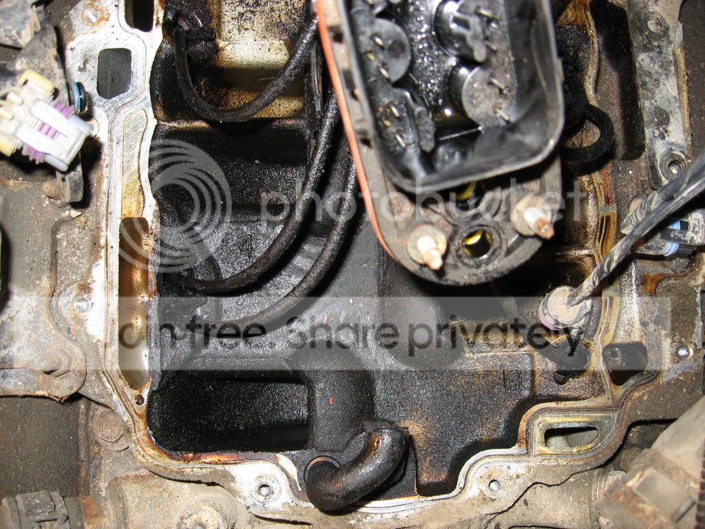

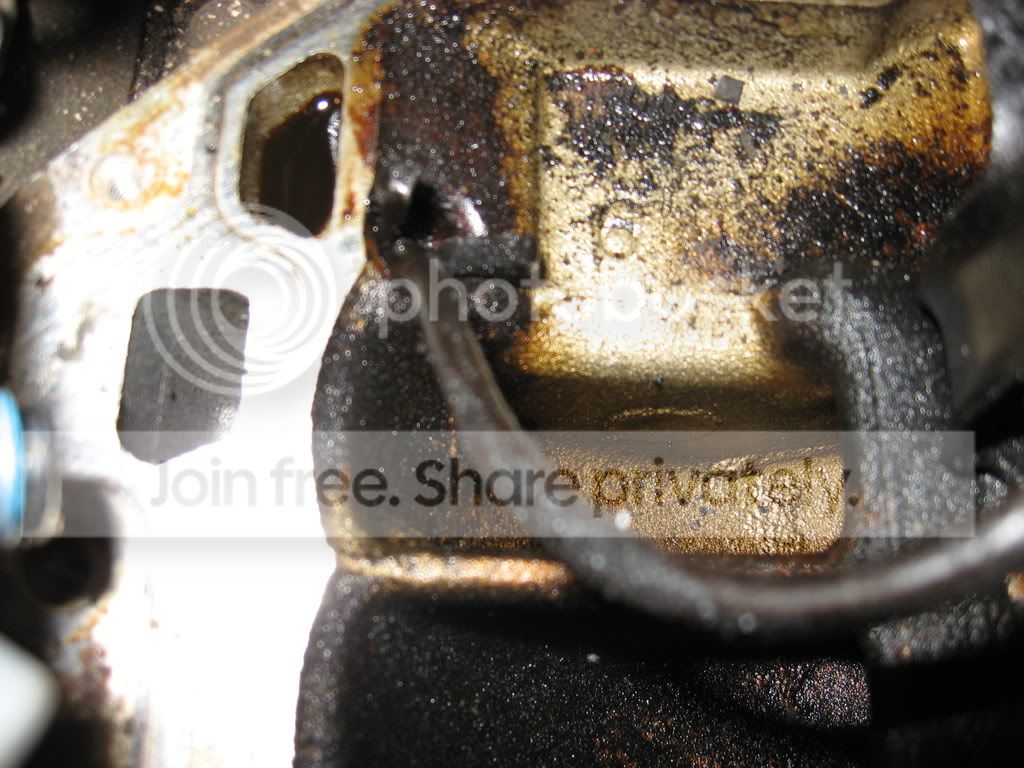

I figured I would go ahead and replace the number six injector. When I pulled off the upper manifold I noticed this. Not sure what it means, if its even bad, but I thought I would ask some of you fellas before I got to much farther. Thanks
The upper left (six cylinder) galley thing there is full of oil, when none of the others are.
BTW 140,000 miles.
Vortec engines are notorious for intake leaks, I would've checked for vacum leaks before removing the intake manifold.
I replaced the number six fuel injector and the misfire jumped to cylinder 5. This has to mean something. Any ideas??
