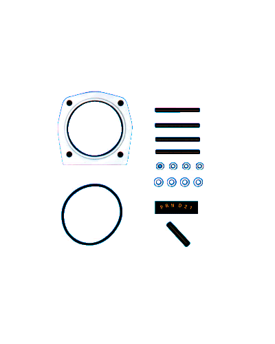

so this is basically all i need
Yep thats the kit i used to put a np205 behind my 700r4. I had to cut down the output shaft one inch with a porta band, to get the 205 to bolt up. It may or may not be required for the 203. A word of advice find a fastenal or good quality hardware store and get u piece of b7 all thread and some self locking nuts to use as studs, the ones they supply dont handle to much power and it aint much fun when u find this out 20 miles from no where...
