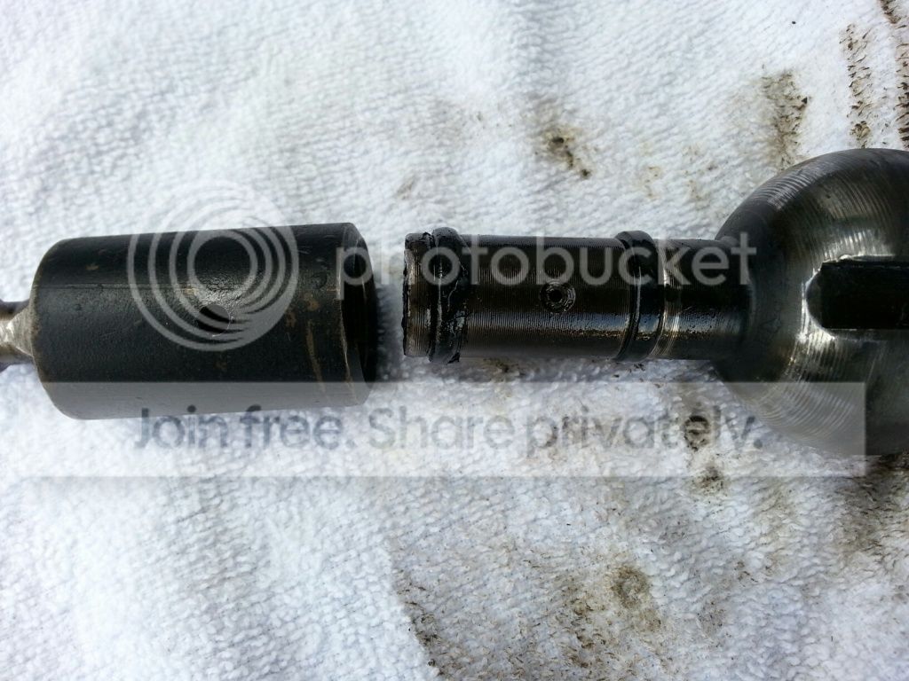

My NP435 stopped shifting...I cant get the lever to engage any gear....
Last night I start to pull the top cover off of the transmission to replace the shift fork pads ( thinking the nylon shift fork pads broke and fell off )
When I pulled the shifter out of the top of the housing,,, I found a roll pin had sheared off allowing the tip of the shift lever ( the actual piece that engages the shift rails ) to roll 360° on the shifter.
the shaft has a few o-rings on it to absorb vibration... and the roll pin stakes the two parts together....that's it's whole purpose in life....
I don't see any reason not to stake a new roll pin in and then take the mig welder and make this into a one piece shifter.....:dunno:
cause when the pin shears,,,,,, your not going anywhere.....
Discuss.....

In the picture you can see the sheared pin......and the o-rings on the shaft.....
I don't see any reason other than vibration isolation that this cant become one piece.....

As far ss I know, this is the same design as a 465 and it does needto have some movement.
Why does it "need" to have some movement??? Most guys with Camaros and Mustangs replace the factory shifter with rigid ones.
Martin
I don't see why it would hurt it. Those o rings hold back fluid and help with vibration up the shift lever. I'd hate to have that happen on the trail. I just wonder what made them break in the first place. Maybe too Much movement inside the two pieces, which will be alleviated by welding them.
Without seeing more of the system, its hard to say.
But the only two reasons I can think of from what I see, is if those two pieces have to come apart to get something else apart, or if the O rings dampen the vibration of the outside shifter shaft so that it does not go down into the transmission and either cause more wear on the shifter pads, or make it want to walk out of gear.
It does seem odd for it to break. If there were room, which there probably is not, I would suggest replacing the roll pin with a grade 8 bolt.
While the pin is probably stronger, its also harder and more likely to crack from stress.
Or, depending on the hardness, you might carefully drill out the holes for a larger pin.
Either way, unless you weld it, I would replace that O ring.......
stuck some new orings on today... drove a new roll pin in and stuck it back together...... shifts like it was brand new.....:woot:
threw the other pin in the glove box....:whistle:
