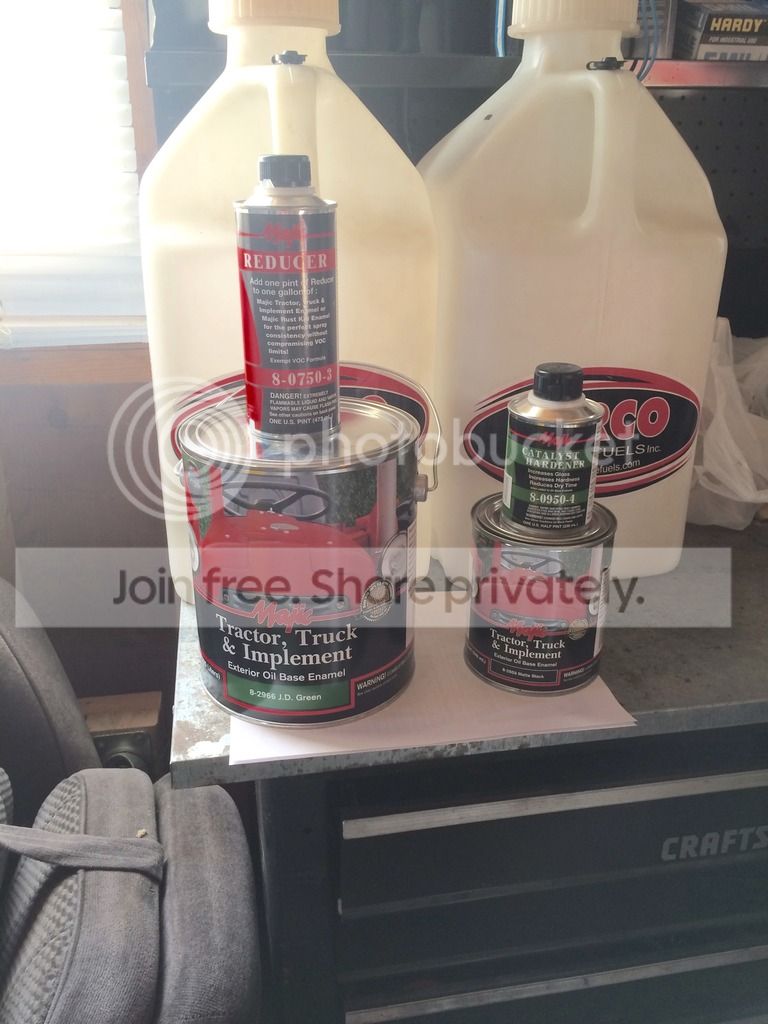

Many of my vehicles had a Rustoleum or Tractor Paint & rolled or brushed on paint job...my '56 Chevy pickup I had years ago was faded black ,I painted it with a brush ,gave it 3 coats of gloss black Rustoleum,during the month of August,when it was very warm,but rather humid--had to wait a week between coats,it took a long time to dry...(should have added some Japan Drier to the paint or Penetrol)..
After a few months I took my electric buffer/polisher and some 3M rubbing compound to it and buffed the crap out of it,my intention was to just get most of the brush marks out,and they were not that bad,the paint flowed out pretty well--it came out nice and smooth,and many commented on how good it looked--even a few body shop guys that were customers at the store I worked at said it came out "dam good" and didn't think a brush job could look that decent..
I painted my '63 VW Beetle and a '63 VW Bus I had with a brush & rollers too,the sponge rollers worked best but they must be changed often or bits of foam pull off and get imbedded in the paint..regular rollers leave a lot of fuzz in the paint..
