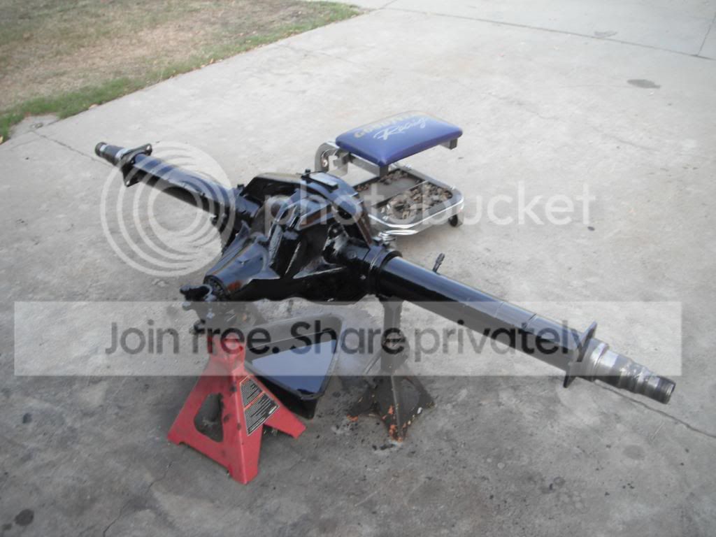

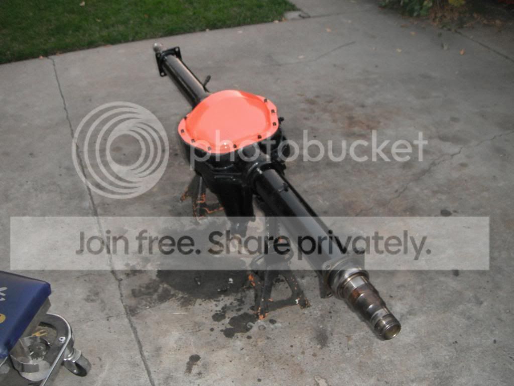

As far as a bare metal rear end I'd do the same thing since it's so easy to touch up and keep looking nice. I'm in the process of rebuilding a 10.25" sterling for my dad and this is just rustoleum ultra coat rattle can. Looks good IMO.
