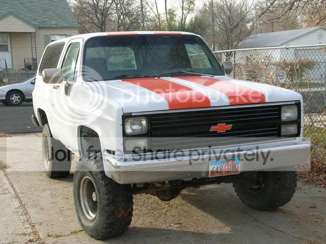

What kind of prep work and paint do you do/use for plastic trim, such as headlight bezels and my grille? I wanna black it all out.
Thanks.
I washed all plastic parts after scuffing them. I used Krylon Fusion plastic paint. Looks real good. Did it in Gloss Black.
Alright nice. Thanks guys. Even if it does flake or whatever it'll only take a couple minutes to redo. Good deal.
running a scuff pad over it is always a good idea, as opposed to "just wash it"... always good to take any shine down..
I wash thoroughly with hot, soapy water, than wet scrub with a scuff pad, dry and paint... SEM colorcoat is really nice stuff, but I hear good things about the Fusion...
never heard of it.... hmmmm, Google.... :haha:
Actually the best, most durable results I've ever seen are with 2-part poly with flex additive and flattening agent added.... :bow:
We used to have to improvise alot back in the early resto days... :wink1:
