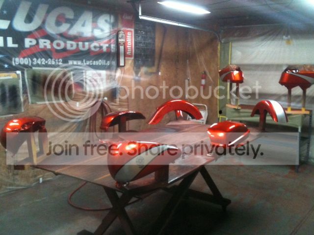

Buddy of mine turned his garage into a paint booth. plastic'd the walls, ceiling and floor. used a bunch of box fans and home a/c air filters both incoming and out going to keep the paint mist down in the hood.
I would avoid the green house treatment for painting... Humidity and temps can be a problem.
I use my one shop stall (22x14) clean it real well, including ceiling, then put plastic on the walls, and cover and seal off the overhead door. I use a furnace filter in the ceiling and have a simple box fan on the opposite end pulling out the fumes.
the furnace filter is between the lights in the ceiling...simple roll of 8'x100' 2 mil plastic on the walls
The box fan is underneath the bench blowing out to the back yard.
