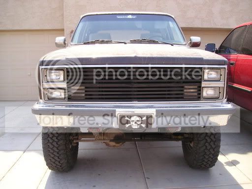

So I got bored with my grill and painted it a few weeks ago. Needs too be sanded and painted again. I also need to exchange headlight bezel with a certain someone so I can get those paint and put on too. :wink1: Also did the dash in a flat black but I have no pics of that yet. Whadda think?

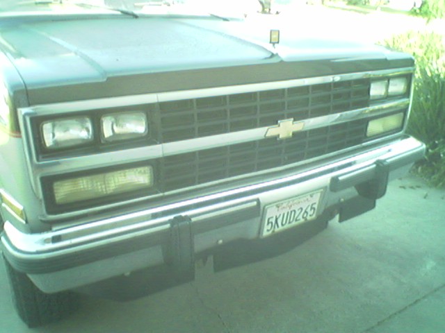

(concerning 89-91)you can paint the black part over again....i did on my 91...just take the grill off and tape off all the chrome...wipe down the areas you're going to paint with like windex(to get off anything that will not allow fusion spraypaint to stick)....spray with fusion spraypaint(works on plastics, metals, and others)
before(faded): http://home.comcast.net/~thfonz98/blazer2.JPG
after: http://www.bowlingballexchange.com//upload_files/grill.jpg
camera phone on the second but the grill looks much better, also did the air deflector below the bumper with the same paint.

The black on my grill was badly faded and the chrome was bubbling, so I had no fear of messing it up. I still plan on replacing it and if the paint on this one holds up, I'll probably paint the new one too because I like the way it looks better. I just sanded it, primed it and painted it with rustomleum Hammered. It's been like this for a couple of months of ddriving with no probs.
That looks awesome! I think I will hafta go ahead and do it, actually looks good with the chrome bumper too. My truck is gonna look like a swat vehicle or CIA or something, It is all black with all fender and side trim removed, and it will soon have black steelies with 38's once I get the one tons in that have been sitting in my shed. The only things that wont be black on it will be the lugnuts, and the silver strip that runs across the tailgait and my bumpers for now.
