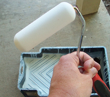

I use a similar but older version at my house for small projects. My guess is that it would make the paint go on way too thick and probably have some sever paint runs. Try it and post pics of the aftermath.
i would go this route.
and either wetsand/polish or runit
dont need to. Can be sprayed, but can be rolled as well. Just needs to be reduced a little with thinner and roll away.
really? reduced like adding how much? this is great news, as i am in the middle of a rattle can job now and HATE the way its coming out simply because the spray can that had my color is CHEAP!!:doah: rustolium sprays nice like, but dont carry olive drab:(
most do 50/50 with mineral spirits.

most use about 6 -8 coats.
you can either let it be or polish it at the end and it looks :eek1:
