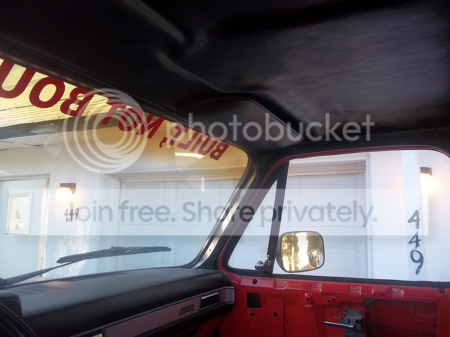

Mutt's stuff.. dashpad was maroon.. hard plastics and visor where white..
