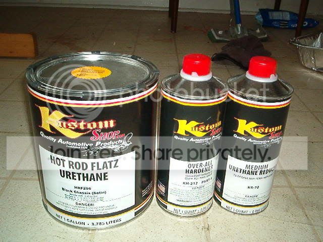

I've recently changed up from running flattened black Imron to buying some Hotrod Flatz satin black catalyzed urethane.. kit was about $160 shipped..
hopefully it rivals Imron's durability...

you mix it prior to spraying.. most urethanes are 4 parts paint to 1 part hardener... depending on the paintline, sometimes you thin it after mixing in the hardener...... usually 5 to 15%.. ya do a poor mans viscosity test... pull the mixing stick out and count seconds till it stops dripping..... 4 or 5 seconds is pretty thick, 8 to 9 is pretty thin... 6 to 7 sprays well thru most guns...
