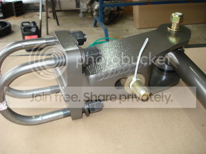

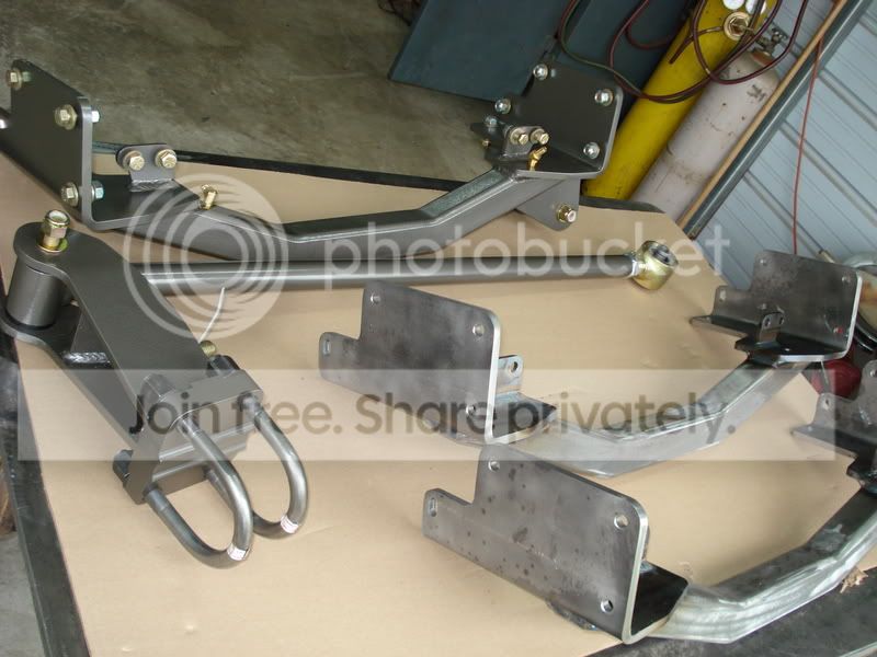

I have a few pics saved from way back when Dave fabbed these up. He started out with one design and changed it to the current one. Still a nice and beefy product. I see he's on Facebook but I never attempted to send a message or bother him.
I have more pics but they're on a flashdrive somewhere.
