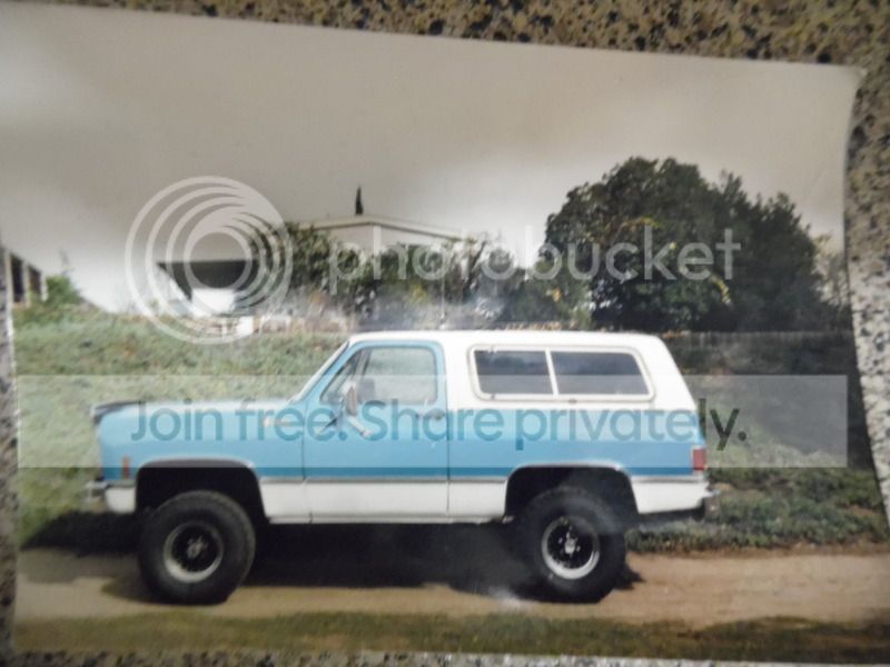

Here is a crappy pic of a pic of my old 77. This is the paint job i want to duplicate on this one.
I have the no slip up front, and it seems to work pretty nice and smooth.
I did a detroit in the rear and that is by far the nicest locker I have ridden in a vehicle with, both on and off road.
That paint job looks nice. I dig it.
