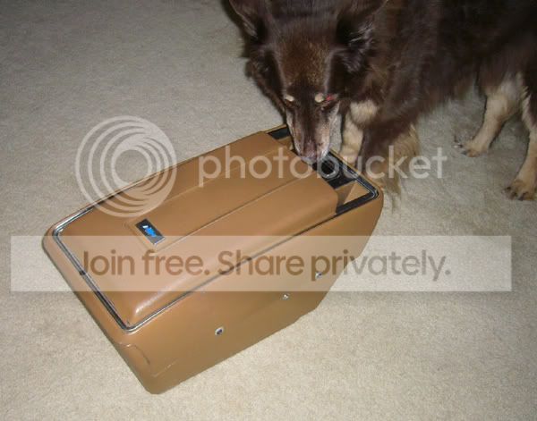

Does anyone know of an easy way to convert either my center console compartment or glove box on my '73 Blazer so that I can lock them when I park my truck somewhere with the top off? I will be mounting my cd/mp3 player in the center console in order to keep the truck looking original (leaving the am radio in the dash) but I would like to find a way to lock it. I would also like to put some kind of a lock on the glove box. Any ideas except bolting on a hasp and using a padlock would be appreciated. I want whatever I use to be barely noticable.

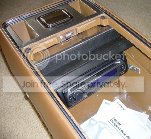

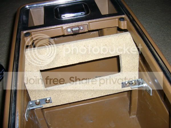

I got the mount made for the head unit
I just did this today, I cut out a piece of wood and mounted it against one of the angled ridges that run up each side of the console.
Then I cut a hole out for the head unit and braced it with angle brackets. I know it looks ugly now but it works and it's really solid. I used bolts and nuts not screws for the mount since I used particle board. I plan to either paint the whole apparatus the same color as the interior (saddle). Or get some speaker box carpet and upholster it in that.

That's my 13-year-old Aussie Shepherd Cinnamon in the first pic!

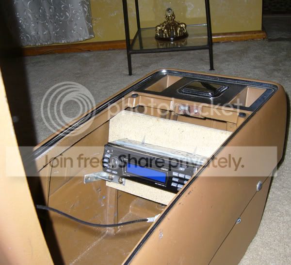

Ok here's the mostly finished product. I got my new CD/mp3/WAV player installed. The only thing I have to do now is seal it a little better to keep water out in case I get stuck in rain. Hope that never happens...

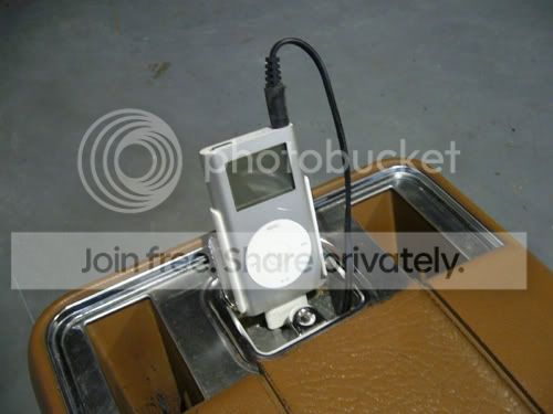

Got the iPod installed...

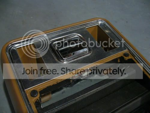

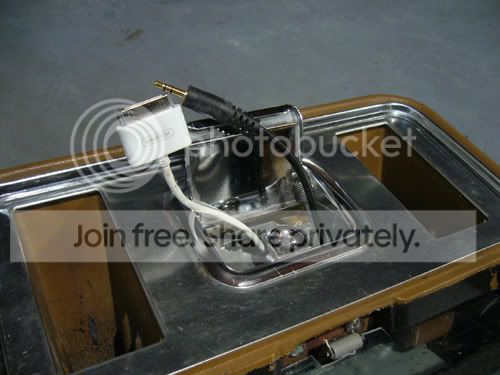

Here are pictures of the iPod hookups, etc. I put in today...
Ashtray closed...
Ashtray open, iPod hookups...

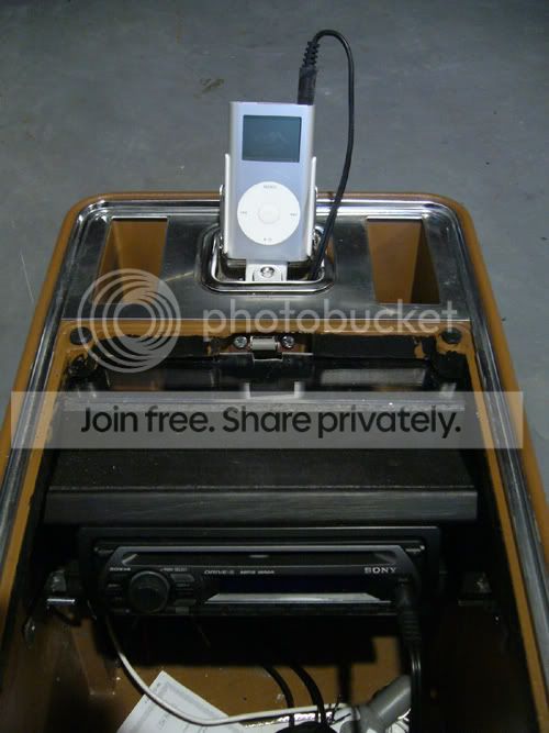

iPod in it's mounted position...
Overview...
