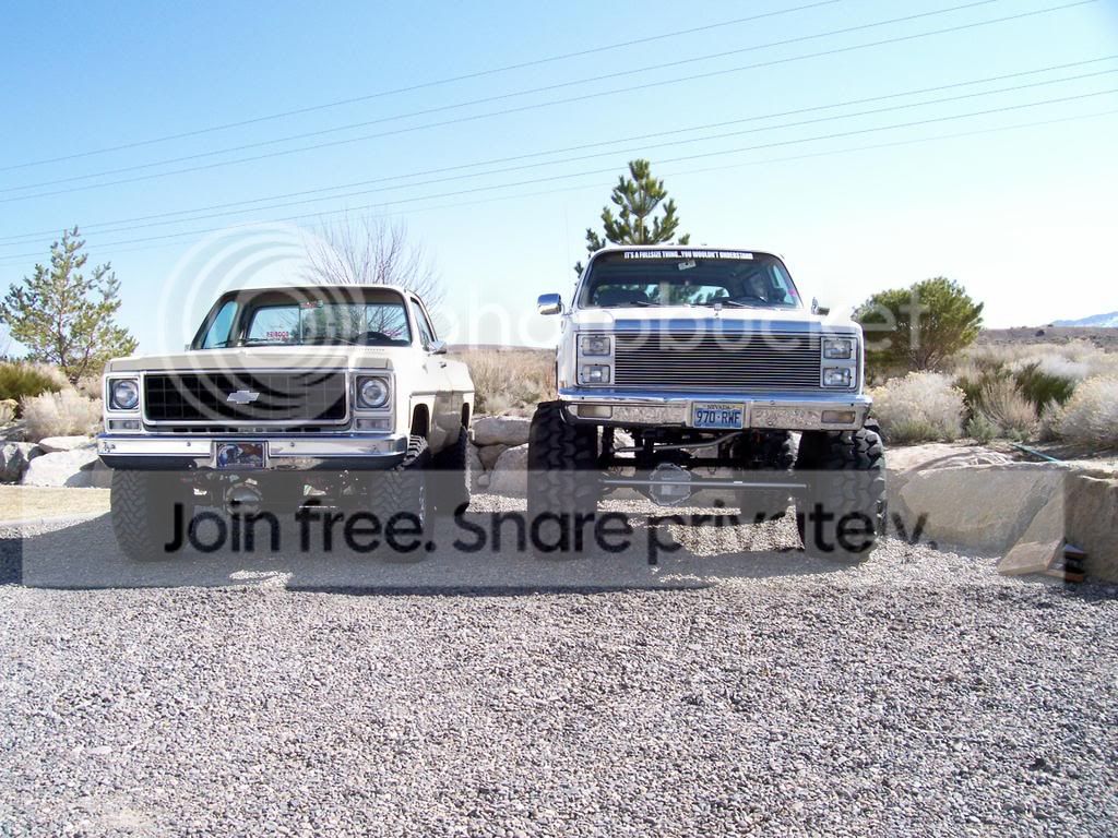

i would like to see some pictures of trucks or k5s with 15x14 wheels, either 2.75 or 4.25 backspacing. i want to see how far they hang out past the fenders:D
not 15x14's, but 15x12's on 44x18.5 TSL's. Wheels have about 4" backspacing..
are you sure thats 4" backspacing? did you have to grind the front calipers on the 60 at all to clear the wheels?
15x12's with weld on beadlocks, so I would guess 15x13 or so. 40" boggers, 4.25" of backspacing, lots of grinding required.
wow, i ordered 15x14 wheels with 2.75" bs. the guy told me that you dont have to grind anything for them to fit so i was like "hot damn, gimme them!". but now i realize they are going to hang out sooo far... oh well :rolleyes:
And they are going to play hell with your front bearings and wheel studs....
It's a leverage thing.....:rolleyes:
If you want to pick up a set of 4.25's, the grinding really isn't that bad. The first side took me 2-3 hours, the second side took me 30-45 minutes. On the first side everyone does the "peck at it and see if it clears" thing (which is what I did), the second side you have a good idea of what needs to be done and can just go to town on it.
