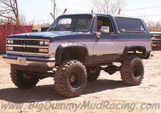

I bought some on craigslist from a guy that "toyed the idea" long enough to get sick of seeing them in his garage- LOL!, My gain!, I am cutting the fenders off next weekend and installing them I will post it. as for look- you could google image it, lots out there. I bought mine from this guy for $150 for the whole set of 4, ha!
Not my truck...google search.
