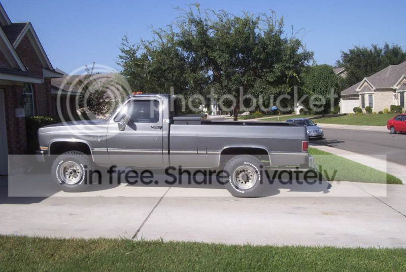

looking for 2-3" lift with 33" tires on true factory k30 1ton truck. side shot pic would be good.
i have a exact idea of what i am going for and just need to see the diffrence in 2" to 3" lift setups. i have 4" now and dont want that anymore for this truck.

Fack! I've got tons of pics of my old '84 K30 with a flatbed riding on Rancho 4" springs #86206 of which the Rancho catalog and site say lifts a K30 only 2.5" since the K30 already sits a little higher than stock K10's and 20's.
And its riding on 33" BFG All Terrains.

Even though the #86206 springs are listed at 4", they clearly do not make a K30 sit like my '85 K30 right now which is riding 4" front and rear Skyjackers. Theres a noticable difference, so at least Rancho was correct in stating those springs would lift a K30 only 2.5".
this truck had 5 front leafs very flat front pack. fit 36s no cutting. these are 33x12.5R16.5
I can see it now, I don't know what was wrong this morning.
I like it. That is the look I have thought about going for with mine.
