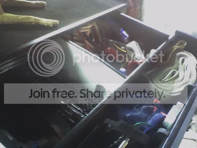

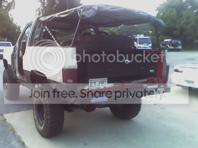

here are the finished pics. Sorry about the delay in posting them I was really busy getting ready for my first wheeling trip. I was able to fit everything I wanted in the box (including 3 folding chairs for the ladies in case someone broke... I'm so considerate) Eventually I'll add some small U bolts to use as tie down points so I can keep my cooler and my spare in there. I have no compliants about the box at this point. All my buddies were giving my hell about it until they didn't have a chain or a hacksaw or wd 40.... then it was the box to the rescue :D . As far as the dimensions it's a 48x24x21 in tall box made from 1/8 in steel diamond plate it cost me about $240 to make. I shot on the hardware with 1/4 inch stainless steel rivets with a big 9X rivet gun. I sealed it up with some weather stripping from Lowes to help water proof it. I can't wait to get a roll cage/ bar put in so I can make an attachment point to hold the lid up while I'm digging around in it. And I placed it as far in between the axles as possible to distribute the weight as evenly as I could. I bet the box weighs about 250 to 300 lbs. But with the doors and tail gate off it evens out.
Edit: I only had the box 3/4 of the way packed and was very happy with it especially since I know next time I could probably pack a few more "comfort items" for the wife.
